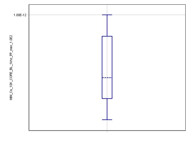

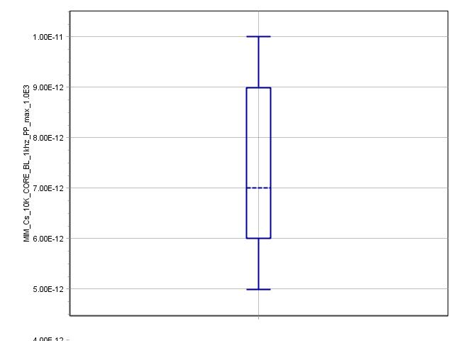

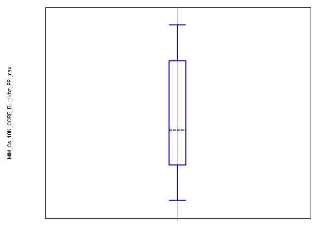

I am trying to create a box plot with the following values and it does not show any labels. I have tried to set max, min and increment in different combination but could not see any labels. I did some experiment by multiplying the values with 1.0E2, 1.0E3 and 1.0E4 and the labels started showing up.
Please let me know what can be done to show the labels as it is critical and most of the test results are in the range of 1.0E-15. Also attaching the charts generated.

Hi GFoundries,
I think that this should format your Left Axis Labels to show the labels as you want:
tChart1.getAxes().getLeft().getLabels().setValueFormat("0.0 'x10'E-0");
However it doesn't work as I expected so I've added it to the wish list to be investigated further (TJ71015194).

Hi Ram,
I'm afraid I can't tell you a date for this to be implemented.
In the meanwhile you could try with custom labels to format the labels your own:
        tChart1.getAxes().getLeft().getLabels().getItems().clear();
        tChart1.getAxes().getLeft().getLabels().getItems().add(5.0E-12, "5.0E-12");
        tChart1.getAxes().getLeft().getLabels().getItems().add(6.0E-15, "6.0E-15");
