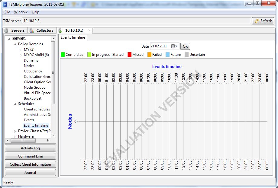

I have downloaded last version teechart for java. But It's evaluation version. Why? Previous version was correctly
- Clipboard-1.jpg (111.32 KiB) Viewed 25555 times

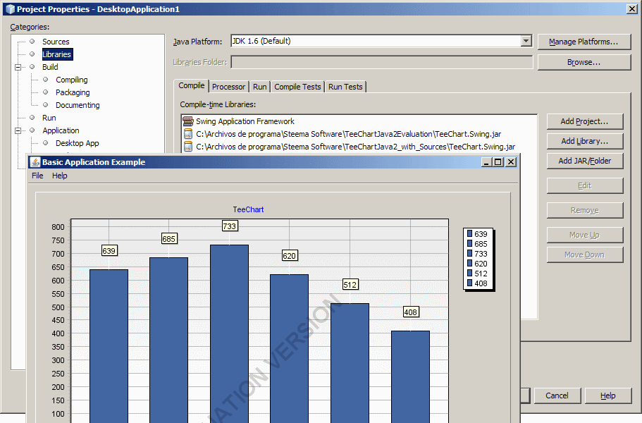

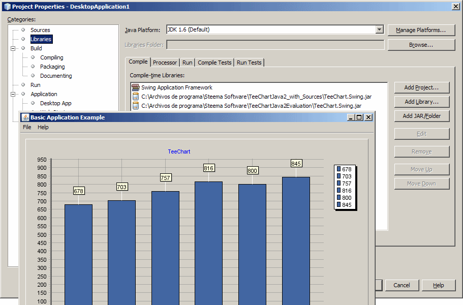

Here, I've just downloaded both the Evaluation (TeeChartJava2Evaluation.zip) and the Pro version (TeeChartJava2_with_Sources.zip) and I can show/hide the EVALUATION text simply changing the order of the paths in a NetBeans application: The test application only creates a Bar series and fills it with some sample values.
I still think it has to be something with the paths, somehow. What IDE are you using?

My screenshot is evidence too and I downloaded TeeChartJava2_with_Sources.zip. I use Eclipse (Helios).
Previous version is correctly

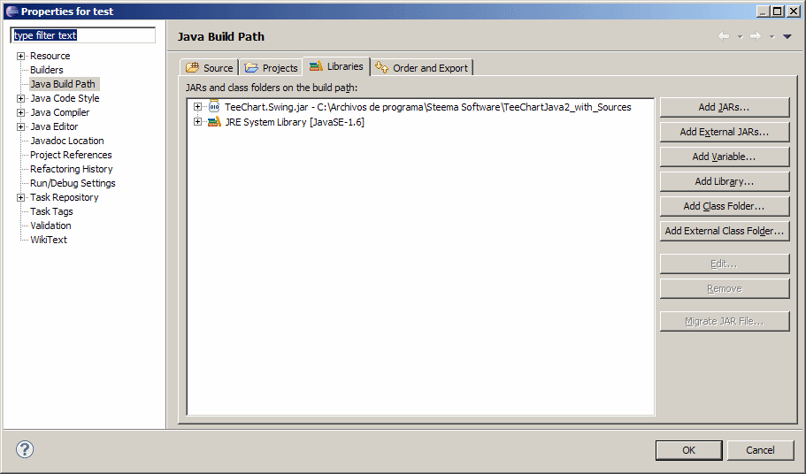

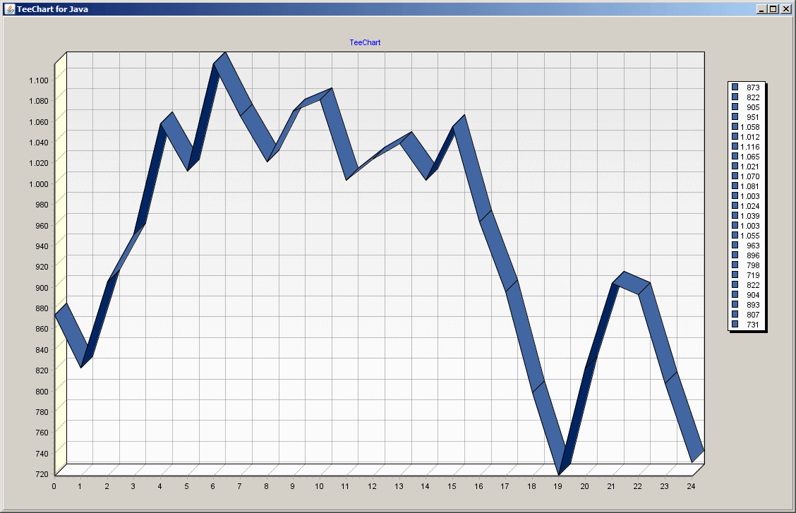

In Eclipse Helios and the following application I see this: In the case of Eclipse, I've seen that having both the eval and the Pro .jar in the list (ordered with your preference) doesn't seem to be enough and the "evaluation" text is always shown. So I have to remove the eval .jar from the library list to show the chart without the text. Could you please check it.
The question is that, as you'll understand, we need to reproduce the problems here in a solid way so we can study why it is happening.
