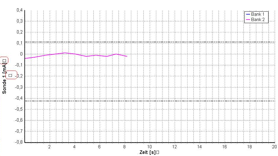

i am using Tchart component in my project.Special characters([]) are displayed at end of Axis titles.This is happening only German windows XP version.
please let me know how to avoid this.

vijay
Posts: 15
Joined: Mon Jun 07, 2010 12:00 am
Re: special characters are displayed in Axis titles
Post by vijay » Tue Aug 09, 2011 8:52 am
Hello Yaray,
Thank you for your reply.
special characters are appeared in German window XP version ( according to my investigation).In other Os It's working fine.
this problem is occurring both in printing the chart and also in the application.

Left Axis text "Sonde 1 [mA]\n ". I added \n to avoid overlapping of title with axis labels ( which was suggested by you).
Bottom Axis text "Zeit [s]".
In the both cases ( both axises) extra special character is appeared in German OS systems.In others It is ok.

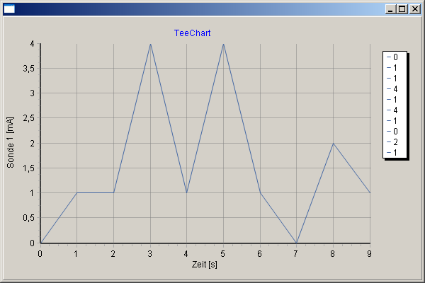

I've installed a fresh German WinXP SP3 32bit + the latest Eclipse Classic + the latest Java SDK + TeeChart Java v2.0.2.271 in a virtual machine.
I've tried both the application you attached here and a simpler version of it with the following code and I can't see the strange characters.

	    tChart1.getAxes().getLeft().getTitle().setText("Sonde 1 [mA]\n ");
	    tChart1.getAxes().getBottom().getTitle().setText("Zeit [s]");
You could try updating your eclipse and java.
