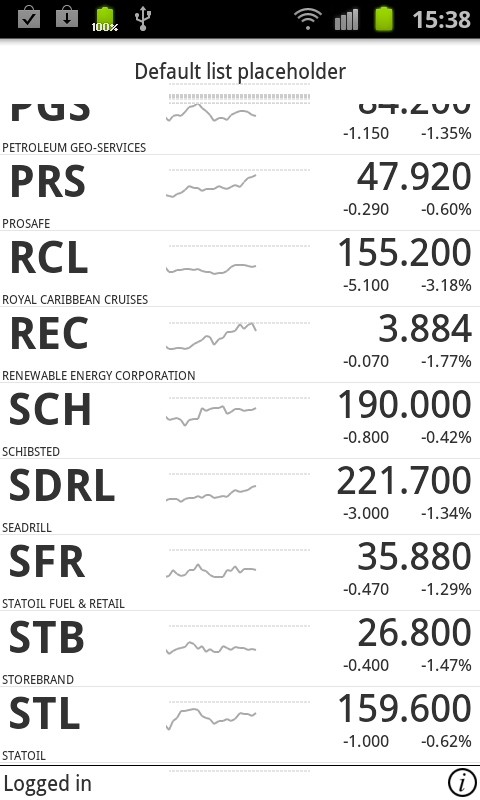

I have added a chart to a list view item. The strange thing is the scroll artifact that is created at the top and the bottom. I have tried changing a few things and determined that the second Line() added to the chart is the one that appears as the defect.

Rendering issue
Re: Android Chart two line series bug.
Post by Yeray » Wed Mar 07, 2012 12:45 pm
Hi Cameron,
I've been able to reproduce it so I've added it to the defect list to be revised in future releases (TJ71016072).
Thanks for reporting it.
