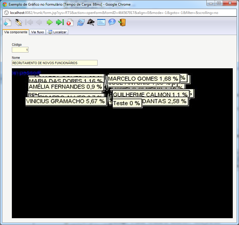

Hello there,
I'm already a customer with v1.
I'm trying to apply the V3 version to see the impacts in my systems and see if the correction's are ok. But, i'm get a black screen in my graph's and i don't know why. Basically, the only change i need to made in my graph call was the img.image() because it wait's for a Dimension class as parameter and my v1 expect int as width and height. Basically, i just put the new Dimension(w,h) into my img.image().
But i'm getting this result (see attachment bellow).
Edit: i'm sorry, i know that this is too much generic, but, i hope you guys could know what's going on.. thanks!

Re: Upgrade from v1 to v3-Eval
Hi Lourival,
I'm afraid I don't remember hearing about something like this before.
Have you tried a new simple project to see if the component works as expected with a new chart?
The data isn't probably relevant here, so, assuming a new simple chart works fine, I'd try to add the code from your old application to this new chart to try to find what is the setting that seems to be causing this.

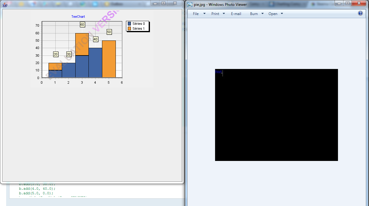

Hello again Yeray,
I got a sample code from the forum and made a little change to export the graph to .jpg
Here is the code:
When you execute the code, you get a black image form it. But it still works in the frame for example. This is the problem that i have: It works in my V1, but not in the V3 evaluation copy.
Edit1: Forget about the name "pie". I was crazy in that moment
Edit2: Perhaps there's something missing before export to file.. But i don't know what it is...
Edit3: Here is the result:
Hi Lourival,
In the meanwhile, using the chartPainted event works fine for me. You could substitute this in your code:
For this:
Yes, something like this. The problem is that the chart has to be drawn before being exported, and the getImage() function doesn't completely do it. I'm trying to find a function (update, repaint, refresh, validate,...) to force a chart repaint before the initial complete window drawing, but I can't find it.Lourival wrote:Perhaps there's something missing before export to file.. But i don't know what it is...
ImageExport img = chart.getExport().getImage();
img.image(new Dimension(1024, 768));
img.getJPEG().save("C:/pie.jpg");
export = true;
tChart1.addChartPaintListener(new ChartPaintAdapter() {
@Override
public void chartPainted(ChartDrawEvent e) {
if (export) {
export = false;
ImageExport img = tChart1.getExport().getImage();
try {
} catch (IOException ex) {
Logger.getLogger(DesktopApplication1View.class.getName()).log(Level.SEVERE, null, ex);
Glad to hear you're better now!Lourival wrote:Edit1: Forget about the name "pie". I was crazy in that moment
