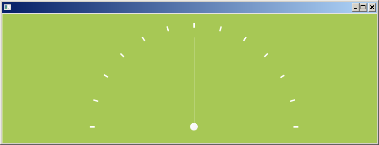

I get the gauges in the image below with the following code:
		tChart1.getHeader().setVisible(false);
		tChart1.getPanel().setColor(Color.fromArgb(167, 200, 85));
		Gauges gauges1 = new Gauges(tChart1.getChart());
		gauges1.setTotalAngle(180);
		gauges1.setRotationAngle(180);
		gauges1.setMaximum(120);
		gauges1.setValue(60);
		gauges1.getVertAxis().getLabels().setVisible(false);
		gauges1.getVertAxis().setIncrement(10);
		gauges1.getVertAxis().getTicks().setLength(10);
		gauges1.getVertAxis().getTicks().setWidth(3);
		gauges1.getVertAxis().getTicks().setColor(Color.WHITE);
		gauges1.getVertAxis().getMinorTicks().setVisible(false);
		gauges1.getVertAxis().getAxisPen().setVisible(false);
		gauges1.getPen().setColor(Color.WHITE);
		gauges1.getCenter().getPen().setVisible(false);

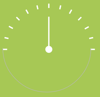

it works but i'm using the android version of this library and i have a half-circle at the bottom which remains.
I don't know how to disable it , to obtain the same chart as you

Post by Mulderone » Thu Jun 07, 2012 7:25 pm
i give you a screen capture of my android app, as you see , i have a gray semi circle at the chart's bottom

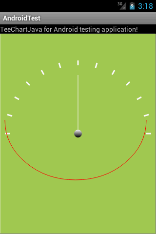

The code above, with TeeChart Java for Android v3.2012.0202, gives me the following result:

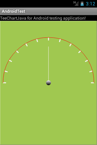

With the changes I sent you, it changes to this:
ok, red.png (8.22 KiB) Viewed 43249 times
Then, if I add the following line:
This is what I get (TeeChart Java for Android v3.2012.0202 with TJ71016219 fix):
Could you please check it again? Please, make sure you make a full Clean&Rebuild.
