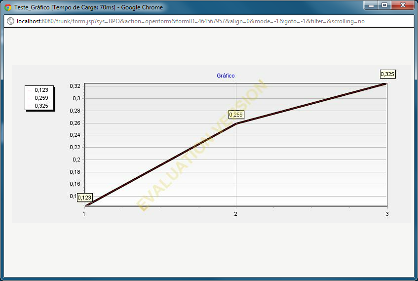

I'm trying to pass values with 6 decimals double number to the graphic.
The problem is: The graphic is showing only with 3 decimals instead of 6.
Am i missing something ?
Follows the images:
Result
Double Value

Hi Lourival,
You just need to set series' ValueFormat, for example:
        Line series = new Line(tChart1.getChart());
        series.add(0.123456);
        series.add(1.123456);
        series.add(2.123456);
        series.add(3.123456);
        series.add(4.123456);
        series.getMarks().setVisible(true);
        series.setValueFormat("#.######");

That's it! Thanks Narcís.
PS: Is there a way to allow any digits, so i don't need to always specify it? Like "*.*" or something like that...

Hi Lourival,
DecimalFormat is being used here. You'll probably need to use as many "0" or "#" as decimals you want to guarantee in your charts.
