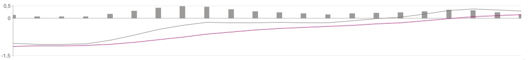

i have a bar chart like this:
now i want a MACD view like this:
How can i use the MACD function? I cannot find an example in the tutorials?
Thanks for ur help!
