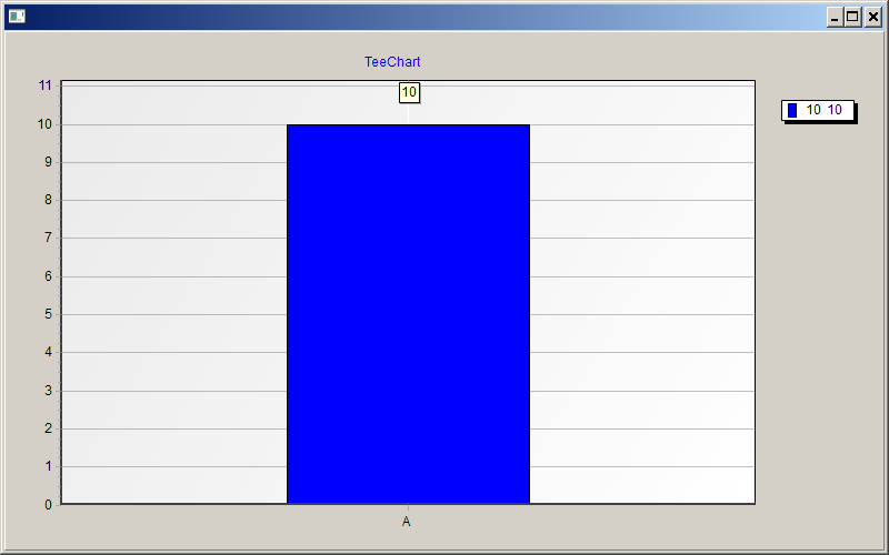

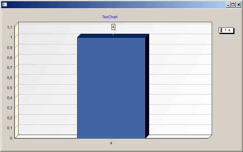

I'd say I'm getting the expected result here in both cases.
Jonathan's code creates a bar series, adds a point with "A" label, changes the point label to "10" and uses custom labels on the bottom axis to show an "A" on the 0 value:
WhebJava code creates a Bar series and adds a point with "a" label:
Please, explain what result would you expect.

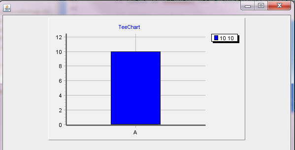

Post by Jonathan » Fri Aug 03, 2012 4:38 pm
I don't see that expected chart in my end. I attached a chart when I ran the sample codes above. As you can see, I don't see the bar label "10".
Missing bar label.png (30.96 KiB) Viewed 28817 times

Re: Mark Label is missing when there is a single bar
Post by Yeray » Wed Aug 08, 2012 12:01 pm
Hi Jonathan,
Thanks to your application I could reproduce it. It seems it only happens in the swing version.
I've added it to the defect list to be revised asap.
