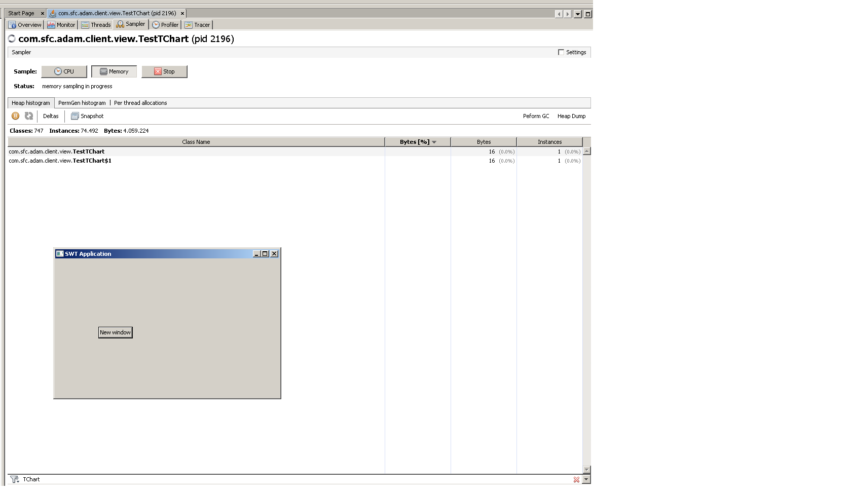

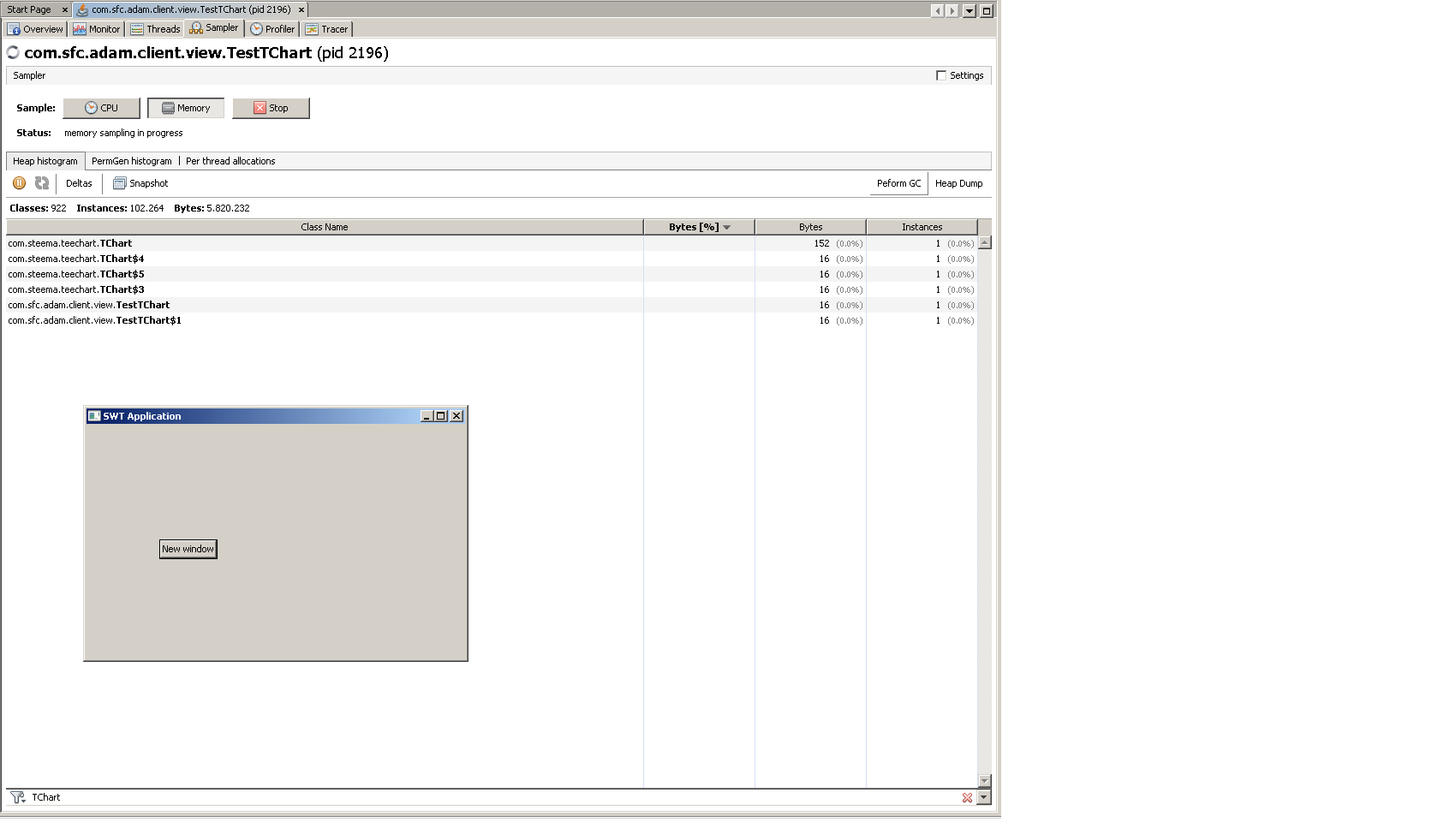

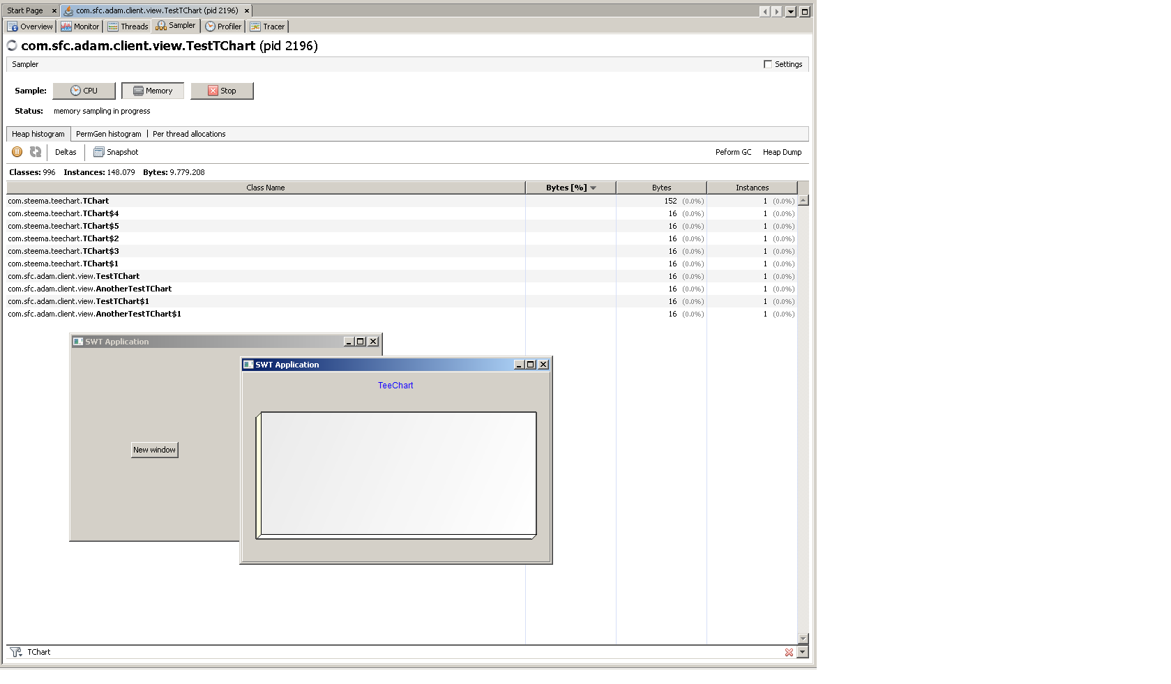

I'm using a VisualVM 1.3.5 for profiling. Take a look at the following pictures:
1. Before opening the window with a chart
2. A chart is created (and five links on it)
3. The window is closed and GC is called
