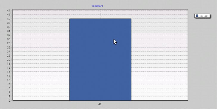

I have created application which use this Bar chart.To show issue to you I have also created Demo application and Chart related snippet is as follow:
        TChart chart = new TChart(this);
        LinearLayout linearLayout = (LinearLayout)findViewById(R.id.linearLayout);
        Bar bar = new Bar(chart.getChart());
        StringList labelsList = new StringList(1);
        labelsList.add(0,"40");
        bar.getMarks().setVisible(true);
        bar.setMarksOnBar(true);
        bar.add(0,40,"40");
        bar.setLabels(labelsList);
        chart.getAxes().getBottom().getCustomLabels().clear();
        chart.getAxes().getBottom().getCustomLabels().add(0.0, "40");
        linearLayout.addView(chart);
I have also tried options that given on below link :
http://www.teechart.net/support/viewtop ... 10&t=13444
Above snippet's result is shown in below image :
Please reply me what to do if I want to show mark when there is only "Single Bar" in Chart ?

Post by Yeray » Mon Jan 28, 2013 2:02 pm
Hi
You can set the Marks visible or invisible with the following function:
And you could check if your series has one value or several with the getCount() function:
bar.getMarks().setVisible(bar.getCount()==1);
