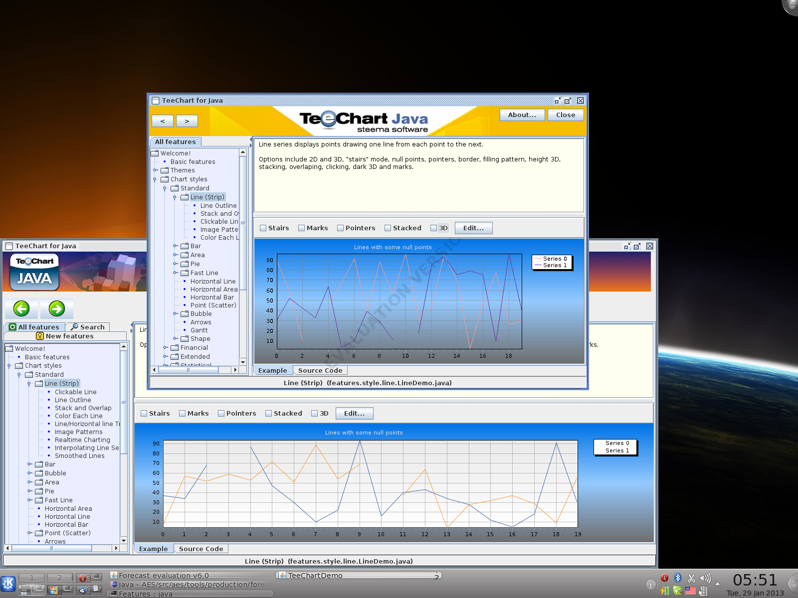

I noticed that when displaying 2D lines, in the legend the color of the lines is almost indistinguishable, very light. See the attachment from TeeChart Java 1.0 TeeChartFeatures.jar and TeeChartJava 3.2012.0808 (the same problem is present in 0202). Am I missing some setting to fix this?
The top window is TeeChart 1.0, the window in background is TeeChart 3.2012.0808

You are right, some change from v2 to v3 has broken this. I've added it to the defect list to be revised for next releases (TJ71016499).
Thanks for reporting it.
