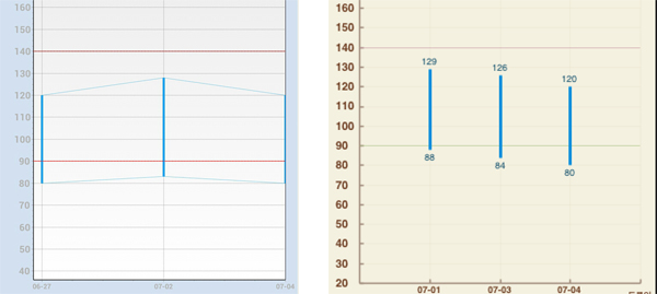

Hi!
I've got a simple a high low chart and I'd like to locate the bars (on the left chart) in the centre like the chart on the right.
(please refer to the attachment)
I'll be glad if anyone lets me know how to do it.
Re: [High-Low Chart] How to locate bars in the centre
Post by Yeray » Fri Jul 05, 2013 1:20 pm
You can set some Offset to both the bottom axis minimum and maximum:
tChart1.getAxes().getBottom().setMinimumOffset(30);
tChart1.getAxes().getBottom().setMaximumOffset(30);
