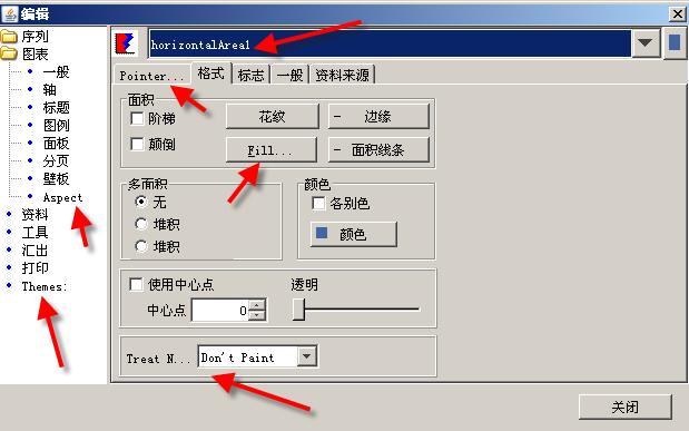

I find that the international languages support of TeeChart for java has some problems.
This will puzzle the users.
For example,
I am from China.
In the edit dialog.
there are some Chinese words at some places, and some English wors at other places.
You can refer to the file in the attachment. I just give an example here. This problem occurs in the other tab
pages in edit dialog.
do any guys know how to solve this problem.
international languages support problem
- international language support.png (22.99 KiB) Viewed 12498 times

That's right. I've added it to the wish list to be improved in future releases (TJ71016689).

hello,
Thanks for your reply.
Could you please tell me some hints on how to fix this problem by myself?
For example, which code or file should be modified?
I think my company have no time to wait for the next release of TeeChart.
When i fix this problem, i can also submit the related file to Steema software.

Hello rubby,
You need to add missing strings at languages_zh_ZU.properties and languages_zh_CN.properties. You may also need to add them at languages.properties. All files can be found at the languages folder in TeeChart Java source code.

Yes please, we will be glad to review and integrate them to our sources.When i fix this problem, i can also submit the related file to Steema software.
