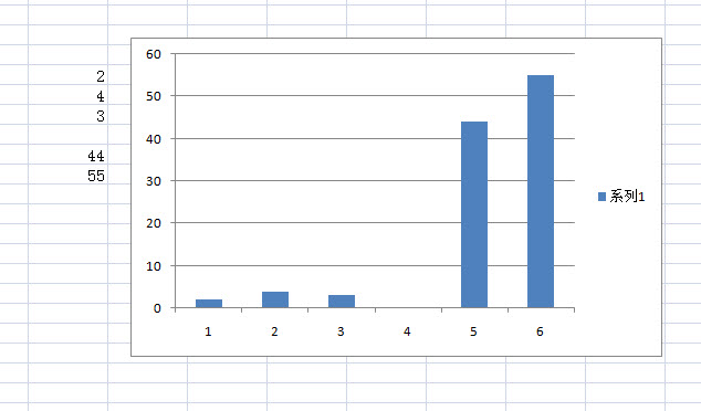

1. I want to know how to add "null" value to a Bar.
Please refer to the attchment, which is waht i want.
There is an empty value among a value list.e.g.,[2,4,3, ,44,55]
How can i create a bar based on this value list?

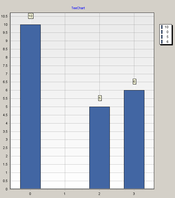

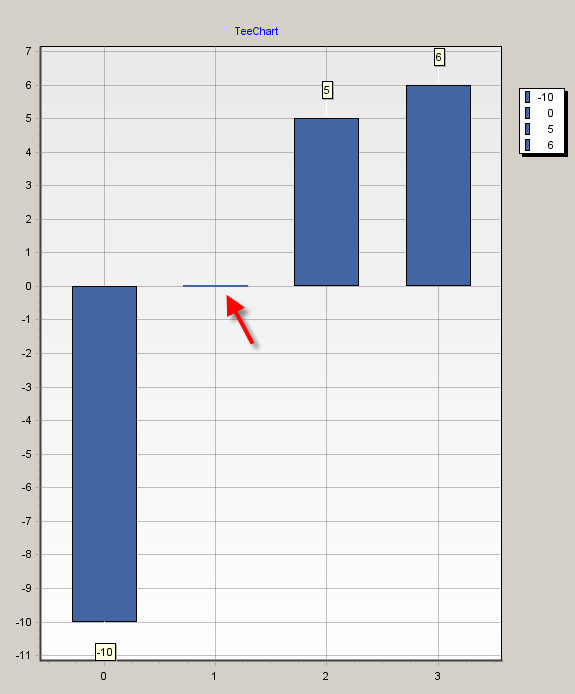

if i use bar.add(-10), it will result that Null will be showed. (Null-2.png)
however, if i use bar.add(10), it will result that Null will not be showed. (Null-1.png)
I think in both cases the null should not be showed.
Posts: 9562
Re: Null value bug
Post by Yeray » Fri Feb 07, 2014 4:32 pm
rubby wrote:if i use bar.add(-10), it will result that Null will be showed. (Null-2.png)
If I scroll down the chart, I also see the null value drawn when bar.add(10) is being used. It's just that it's so thin that it's not visible with the default axis scale.
rubby wrote:I think in both cases the null should not be showed.
I've added it to the bug tracker:
http://bugs.teechart.net/show_bug.cgi?id=565
Feel free to add your mail to the CC so you'll receive an notice when the status of the ticket will change.
