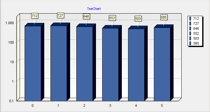

Yes, take a look at the following code:
        Bar bar1 = new Bar(tChart1.getChart());
        bar1.fillSampleValues();
        try {
            tChart1.getAxes().getLeft().setLogarithmic(true);
        } catch (ChartException ex) {
            Logger.getLogger(ChartJFrame.class.getName()).log(Level.SEVERE, null, ex);
This is how it looks the chart after running the above:
