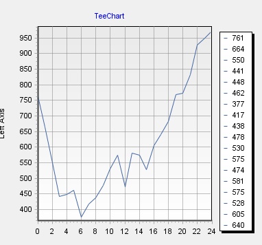

Setting a minimum or maximum offset on a vertical axis using setMinimumOffset() or setMaximumOffset() causes the axis title to be displayed off screen until the chart is re-sized to be larger. If the maximum and minimum offsets are removed the title is displayed as expected.
When this example is loaded "Left Axis" is usually not visible until the window is re-sized. If the maximum and minimum offsets are removed "Left Axis" is displayed as expected.

Here is what I get in TeeChart Swing. Is this the environment you are using and what you are getting?
If this is not what you are observing, please try to arrange a simple example project we can run as-is to reproduce the problem here.

Yes that is what I am seeing. Notice that the string "Left Axis" is partially off screen. Resizing the window smaller will have is disappear further off screen. This problem does not occur when not using setMaxiumOffset and setMinimumOffset.
