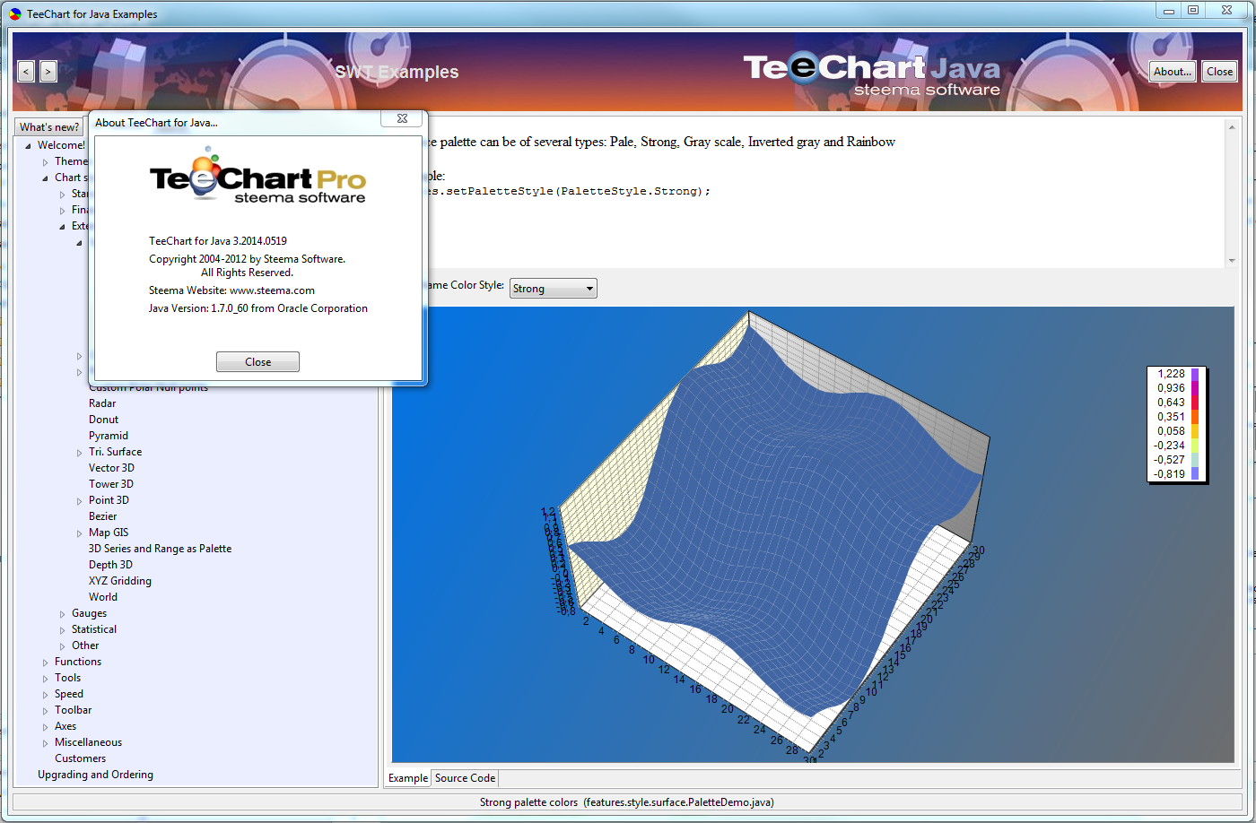

I have a problem with the Surface chart style.
I cannot get the surfaces colorized according to the magnitude of the y-values. The legend shows different colors as expected but the surface only shows one color.
Also your examples application have the same problem.
Color on surface plot
- Surface.PNG (427.82 KiB) Viewed 63163 times

Hi John,
This is a known bug already present in the public tracker:
http://bugs.teechart.net/show_bug.cgi?id=436
I've incremented the ticket priority.

Re: Color on surface plot
Hi Johan,
I've revised the ticket, found a fix for it and prepared an installer.
I'm sending a mail to the account you have registered in this forum with the link to the new installer.
