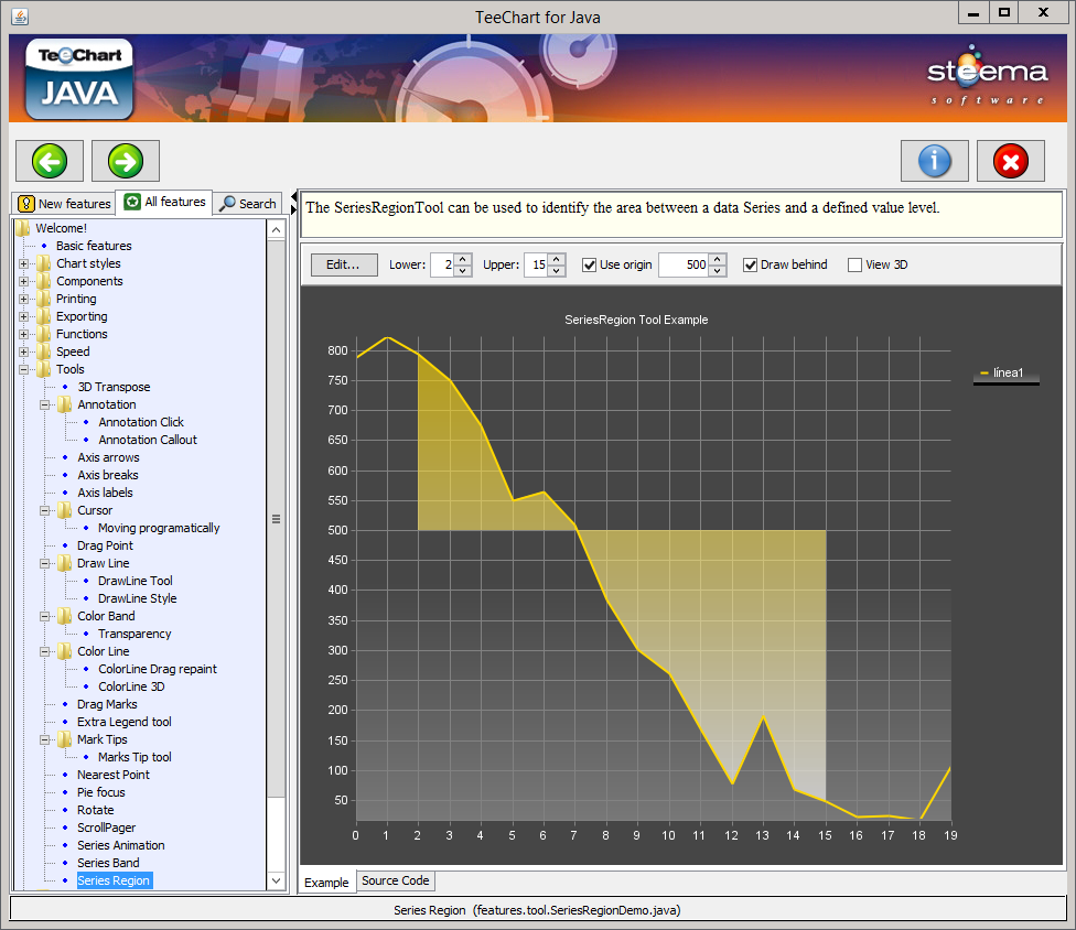

In \Examples\Swing\Features\TeeChart.Features.jar
Go to whatever example you want - In the Commander --> Edit --> Tools --> Add - is not opening.
Avi
Re: Tools add
Post by Yeray » Tue Sep 23, 2014 12:06 pm
I see SeriesRegion.gif was missing in that build and it causes the Tools Gallery to fail.
Put this file into the "\src\Swing\com\steema\teechart\tools\icons" folder to fix it.
