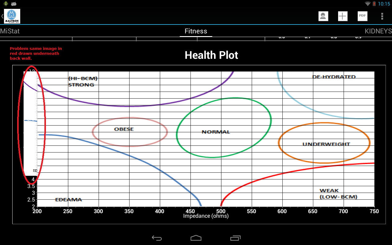

Problem is Loading a png image to back wall so appears between left axis and bottom axis,
but the same image is appearing over left axis see attached file.
Back Wall load Image.png (159.62 KiB) Viewed 78474 times

The example shows image between axis as required.
But there is a second reduced image overlapping the y-Axis.

Simplifying your testing app, this still reproduces the problem:
    @Override
    protected void onCreate(Bundle savedInstanceState) {
        super.onCreate(savedInstanceState);
        setContentView(R.layout.activity_main);
        createChart();
        testLoadImage();
	private TChart tChart1;
	private void createChart() {
		LinearLayout layout = (LinearLayout) findViewById(R.id.chart_layout1);
		tChart1 = new TChart(this);
		layout.addView(tChart1);
	private void testLoadImage() {
		Bitmap bitmapLogo = BitmapFactory.decodeResource(
				getApplicationContext().getResources(),
				R.drawable.health_regions_chart);
		tChart1.getWalls().getBack().getBrush().setImage(new Image(bitmapLogo));
I've added this to the public tracker:
http://bugs.teechart.net/show_bug.cgi?id=943

sol wrote:When can I expect this bug to be fixed as required by our Android program?
I've just applied a fix for this in our internal sources and I've closed the ticket, so the next maintenance release will include the fix.
