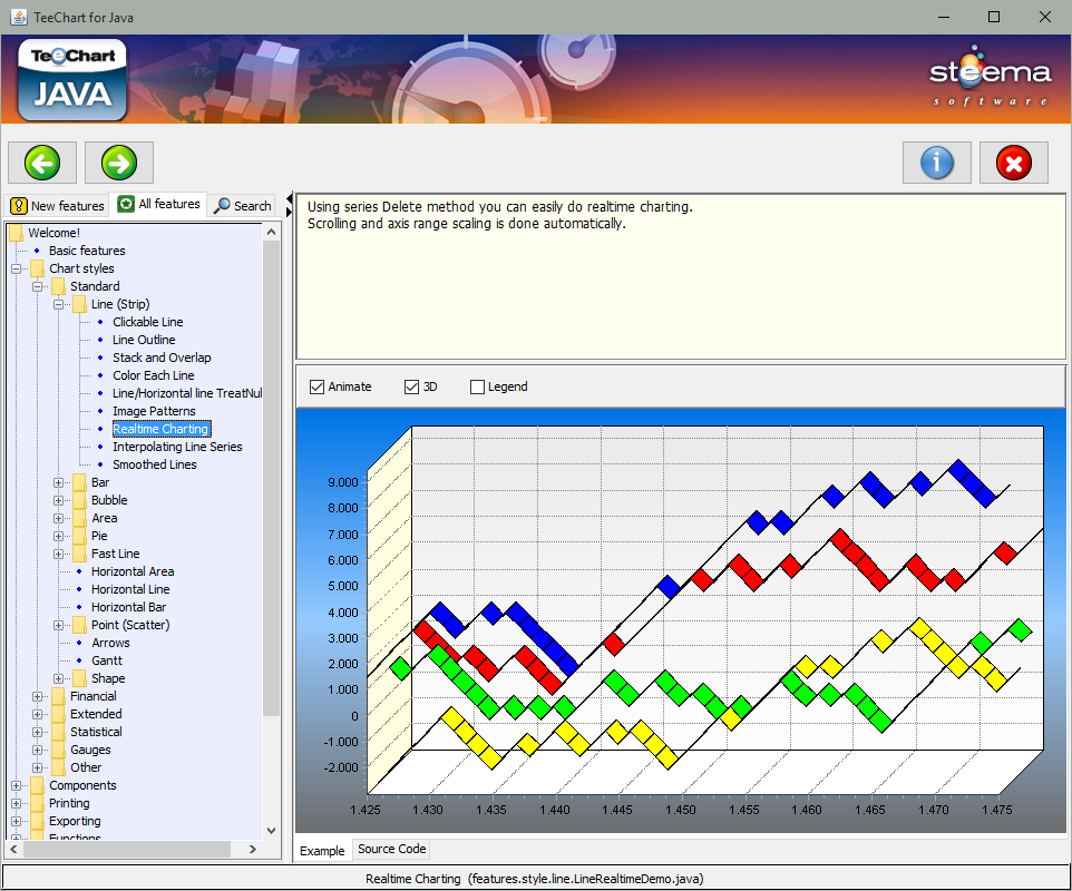

Re: chart in real time
Post by Yeray » Fri Oct 16, 2015 3:53 pm
Hello Dimitry,
Take a look at the RealTime demo in the Swing Features Demo:
