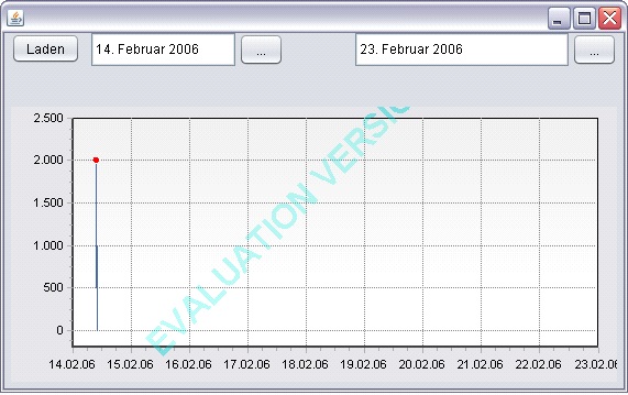

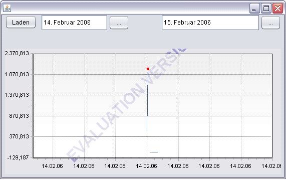

My problem is the line drawing between several points including a gap:
I'm using Fastline series to show bigger data series (1-3 Mio data points), but the problem appears with 10 data points too.
The chart performance of the function setDrawAllPoints(false) works for me.
But I realized several situations, where the line drawing between two points is not what I'm expecting:
Example:
A Fastline data series with a time axis contains 5 Points: 500, 2000, NULL (I want a gap), 0,1, ...
I expect a line from 500 to 2000, a gap and the next line from 0 to 1. The one picture shows the right drawing.
But from time to time, the diagram with the same data looks like the other one picture - the gap is missing and there's a "wrong" drawing from 2000 down to 0. The only change is a wider or smaller time-line on the x axis or a bigger or smaller window - but there's no clear relation: One time, it is right, the next time it is wrong.

- Wrong drawing
- Wrong drawing.jpg (74.42 KiB) Viewed 62090 times
- Right Drawing
- Right drawing.jpg (70.97 KiB) Viewed 62092 times
