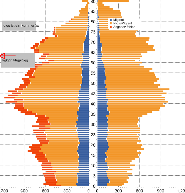

when I move a Shape near the left border of my TChart (e.a. shape.setX0(2)), the Shape competely disappears. Values for X0 > 5 work fine. If the X0-Value gets smaller than 6 the shape disappears. Is there a setting, that I can make to prevent the shape from disappearing even for values smaller 0?

Finally I found the time to arrange a simple example project. Sorry for the long time between my answer.
The projekt is written in Netbeans 8.2. In cause of the Upload-limitation, I had to remove the TChart.Swing-Library from the dist-directory.

Hello Oliver,
The problem lies in a missing variable setting in Shape Series.
If you have access to modify the sourcecode, the change is here:
Shape.java
Constructor:
    public Shape(IBaseChart c) {
        super(c);
        shape = new TextShape(c);
        calcVisiblePoints = false;   //<--- add this line.
        addDefaultPoints();
We are making the change to the source to be included with the next update.
(logged here: http://bugs.teechart.net/show_bug.cgi?id=2222)

Hello Marc,
your workaround works fine for my problem. Thank you.
