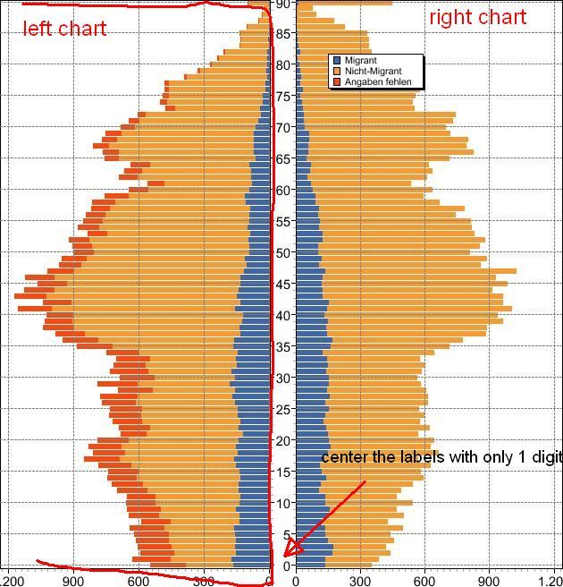

is it possible to center the text of the y-axis-labels?
- see picture below
- the picture contains 2 TChart-charts
- the y-axis-labels are contained in the right chart, but I think that's not important
regards,
Oliver

At the moment there is only default or opposite alignment of those labels. Am looking here if I can suggest an alternative approach. I'll get back to this thread.

Hello Oliver,
I'll send you modded TeeChart code units to your registered email address so that you can test the proposed solution to this problem.
