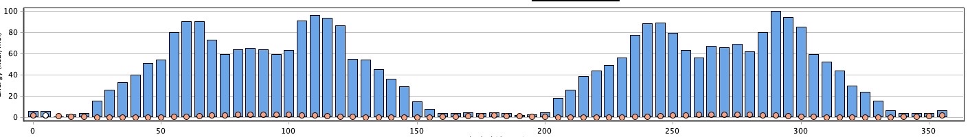

Hi, please refer the chart below. I'm trying to create a single chart with a bar graph, points. Since the values of the bars are larger than points (i.e maximum value of the left axis is so big), they look almost 0 value. Is there any solution? I'm thinking of adding a different scale on right for points and so that it can have its own minimum and maximum. Please help if there's a better solution for this problem. If you have any further questions, I would be happy to answer. Thanks in advance.

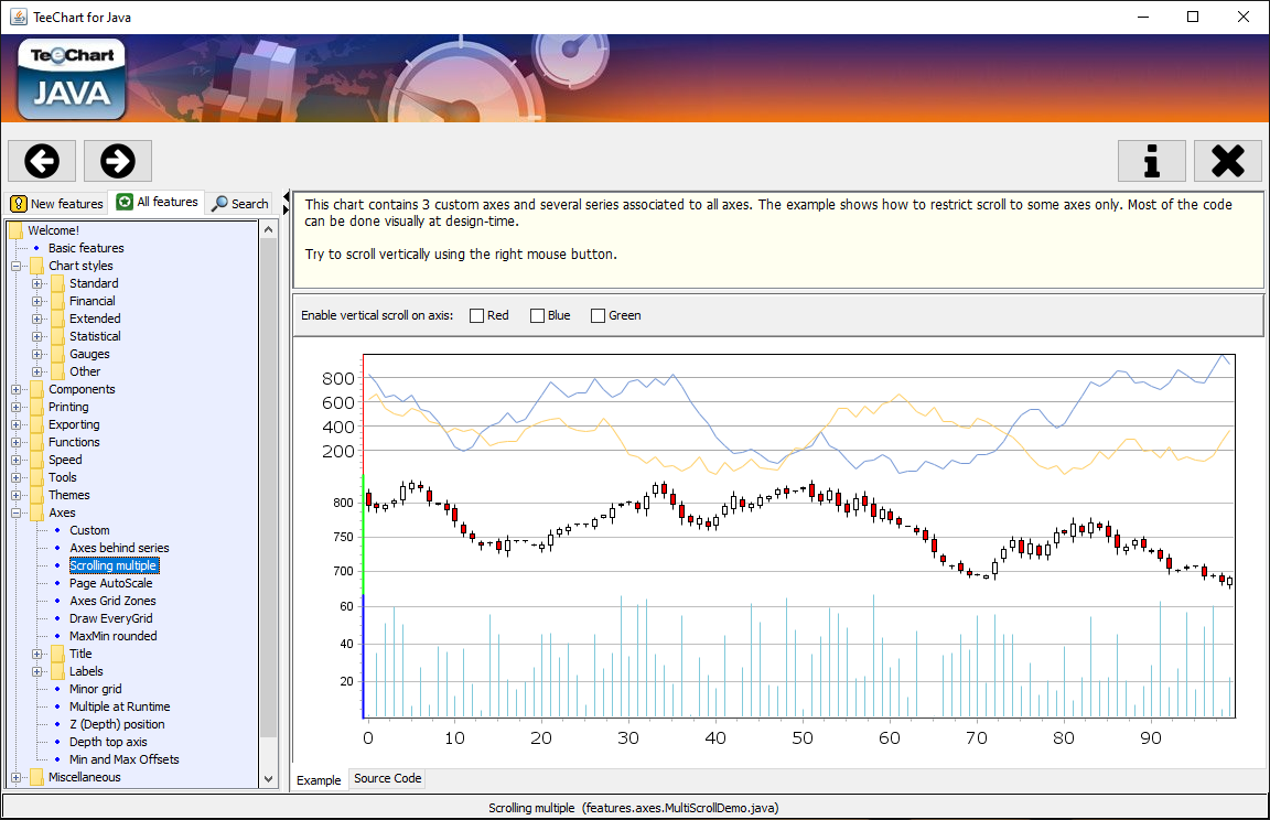

One of the the most common solutions to this issue is what you mention: to make the right axis visible and assign a series to it.
An alternative would be to add a custom axis at the left side and assign a zone to each axis, like in the MultiScrollDemo:

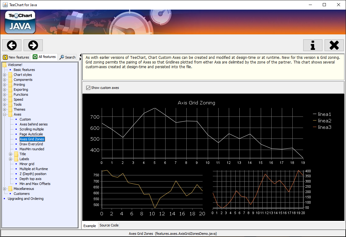

Here another example about using custom axes:
