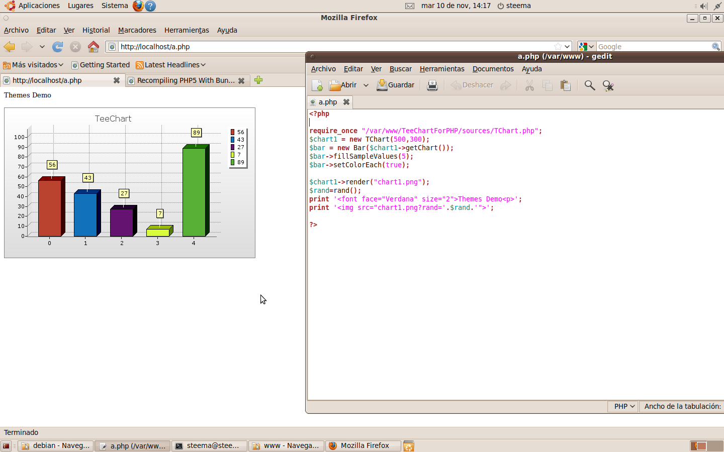

Yes, I've made a test in a fresh install of Ubuntu 9.10 the last week and I've found some problems with GD library but I managed to run it by recompiling the PHP following this instructions.
See the attached example that worked for me here: And the result: What we haven't tried is in 64 bits.

I made instructions trying to explain the process from where I could get TeeChartforPHP work in an Ubuntu 9.10:
Excuse us for the delay. We are not very familiar to linux as we don't usually use it.
- Fresh install Ubuntu 9.10
- Update through update manager
- Install php5 through synaptic
- sudo mkdir /var/www/TeeChartForPHP
- Download TeeChartForPHP
- Unzip the content in TeeChartPHP1Evaluation.zip to /var/www/TeeChartForPHP
- Download and place a.php into /var/www/
- sudo chmod -R 777 /var/www/
- Rename the file /var/www/TeeChartForPHP/sources/themes/y2009.php to /var/www/TeeChartForPHP/sources/themes/Y2009.php
- Browsing to http://localhost/a.php gives the following:

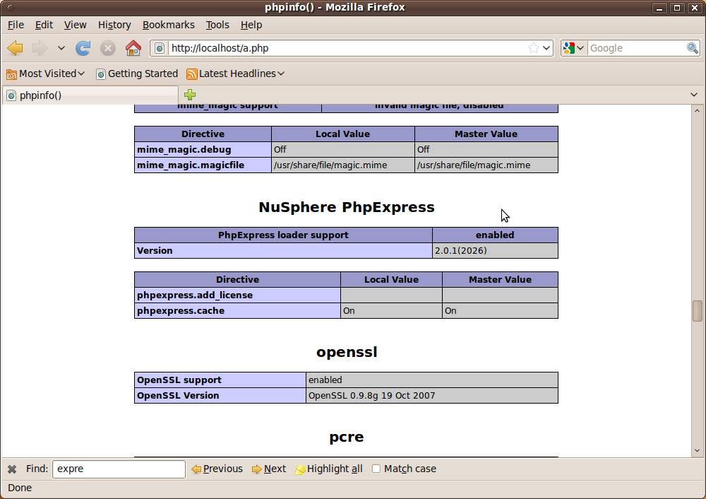

"file /var/www/TeeChartForPHP/sources/TChart.php requires Php Express loader to be installed by the web site administrator."
If I...
- Download http://www.steema.com/products/teechart ... oaders.zip
- Unzip the phpexpress-php-5.2.so file from loaders.zip/loader/phpexpress-2.0-Linux-glibc-2.7.tar.gz/phpexpress-2.0-Linux-glibc-2.7/x86/ to /var/www/extensions/
- Edit the php.ini file to load the phpexpress extensions:- - sudo gedit /etc/php5/apache2/php.ini
- - At line 508: extension_dir = "/var/www/extensions/"
- At line 621: extension=phpexpress-php-5.2.so

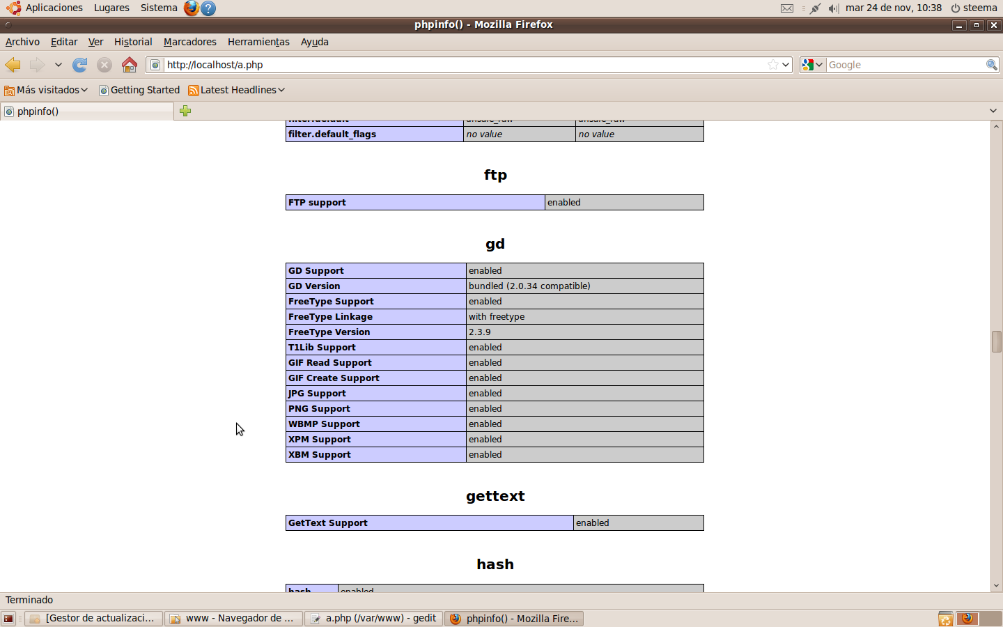

Fatal error: Call to undefined function imagecreatetruecolor() in /var/www/TeeChartForPHP/sources/GraphicsGD.php on line 698
To solve this, we have to recompile php5 as explained in the web said above:
- sudo apt-get install build-essential debhelper fakeroot
- cd /usr/src
- sudo apt-get source php5
- sudo apt-get build-dep php5
- cd php5-5.2.10.dfsg.1
- sudo gedit debian/rules- at line 220: --with-gd=shared --enable-gd-native-ttf \
- cd ..
- sudo dpkg -i php5-gd_5.2.10.dfsg.1-2ubuntu6.1_i386.deb
At this point, having enabled the nusphere loaders, the GD library isn't loaded successfully and it gives me an error so I had to comment the lines I've added in the php.ini
- sudo /etc/init.d/apache2 restart
Now you should see a chart if you open a browser and call http://localhost/a.php - - sudo gedit /etc/php5/apache2/php.ini

Of course, here it is:streamfoundry wrote:Do you have a copy of the resulting php.ini extension statements?
After loading them in the beginning of the process, I could see them enabled running the phpinfo function. And at the end of the process, after removing them from the php.ini, I can't find them in the phpinfo function result, but the chart seems to work without problems.streamfoundry wrote:You sure the extension=phpexpress-php-5.2.so statement isn't still in there?
