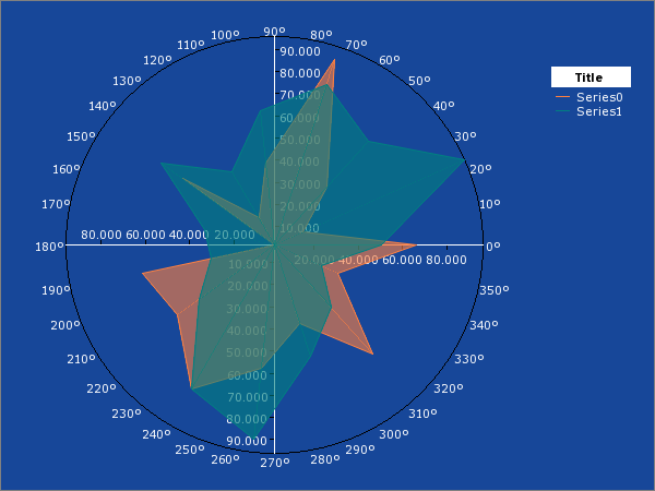

New Polar Series style added to the TeeChart for PHP (source code) version:
I'll send you the modified TeeChart PHP sources that include that new style and a demo using it.
