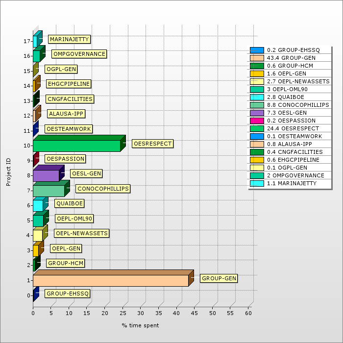

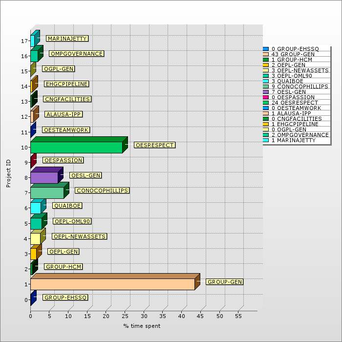

Look at the attached .png files which compare the quality of charts from the 2010 version and your very latest (May-2014) version. You can see that the chart Legend in the 2014 version shows the lines separating the legend texts actually touching the texts. The chart from the 2010 version is of better quality.
- Legend lines are not adequately spaced for the legend texts
- TChart2014-Sample.png (66.68 KiB) Viewed 106499 times
- Crisp and clear Legend -lines are optimally spaced
- TChart2010-Sample.png (71.4 KiB) Viewed 106470 times
