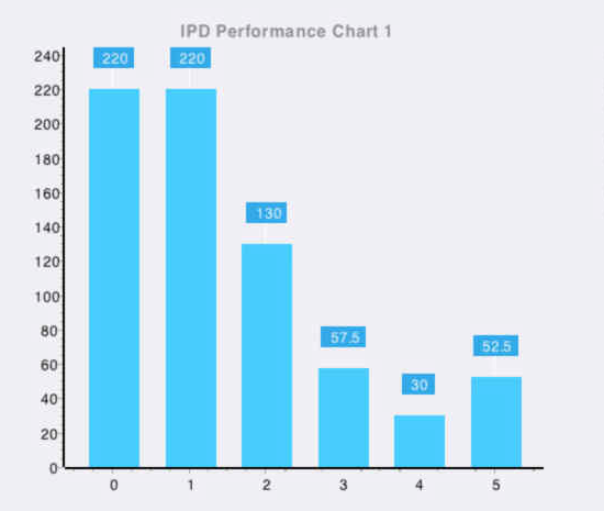

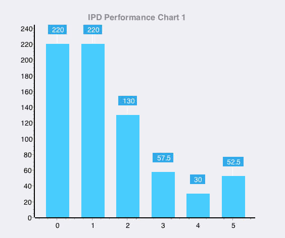

I hadn't thought of the Simulator, but actually I can reproduce a bit of the problem there - it is actually worse on the device, but can you see the difference quite clearly in quality.
Non Retina
Retina

Right, switching to iPad Retina simulator I could also reproduce the problem.
We're investigating this further.
