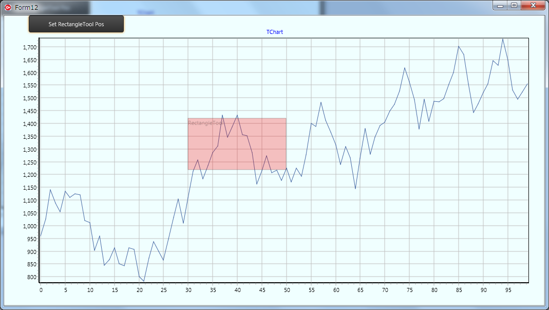

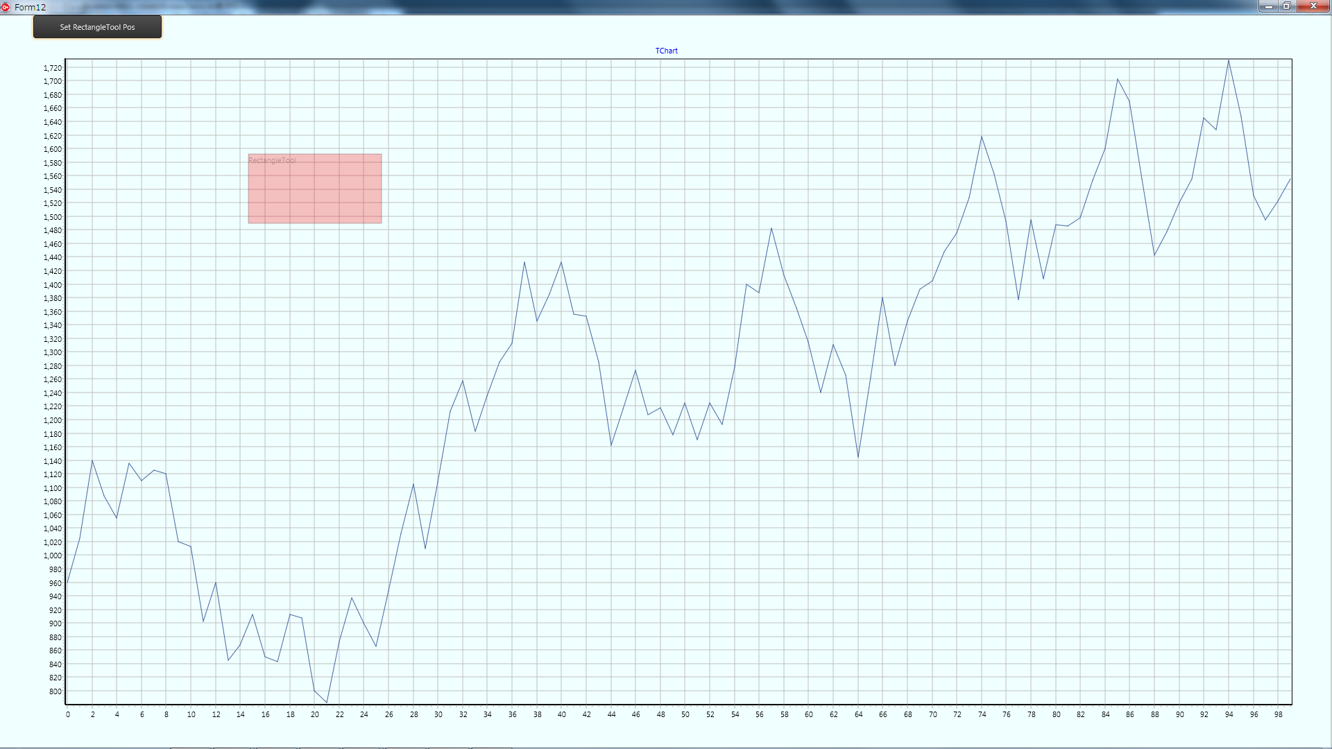

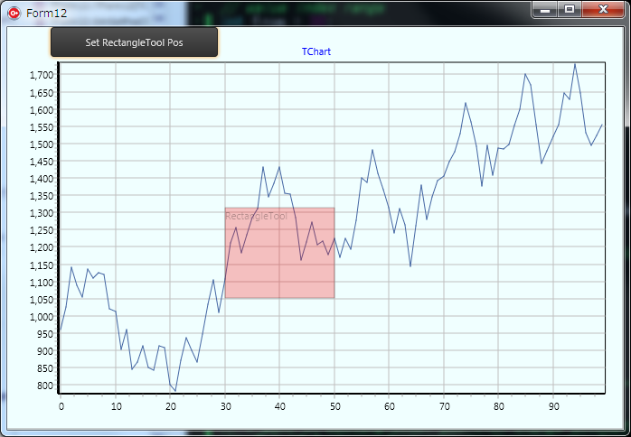

I want the RectangleTool position change automatically when form size changed.
But if I change form size by dragging the from border, it seems OK,
while nothing changed when maximize the form.

// I want the RectangleTool position change automatically when form size changed.
//  But if I change form size by dragging the from border, it seems OK,
//    while nothing changed when maximize the form.
Resize Form by Maximizing Form.png (192.17 KiB) Viewed 17222 times
Resize Form by Dragging Form Border.png (84.84 KiB) Viewed 17224 times
Before Resize Form.png (75.94 KiB) Viewed 17222 times

Hello elmec,
Sorry for the delay.
After doing some test, we have realised that the problem you are experiencing is produced because is necessary repaint the chart before using CalcXPos method, so the Chart has correct values. To do it you need only add Draw Chart method and call BtnSetPosClick in OnPaint Form event.
Below, I have attached your project with the modification.
