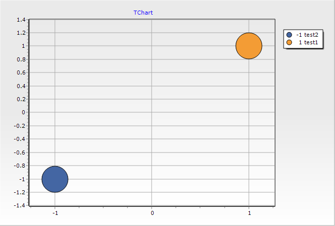

I've added a chart to a new simple application using TeeChart v2015.14 and the following code:
uses BubbleCh;
  Chart1.View3D:=false;
  with Chart1.AddSeries(TBubbleSeries) as TBubbleSeries do
    AddBubble(1,1,0.2,'test1');
    AddBubble(-1,-1,0.2,'test2');
And this is what I get, that seems to be correct to me:
If this is not what you are getting please tell us what environment are you using (what exact TeeChart, IDE version and OS) and please arrange a simple example project we can run as-is to reproduce the problem here.

Hi.

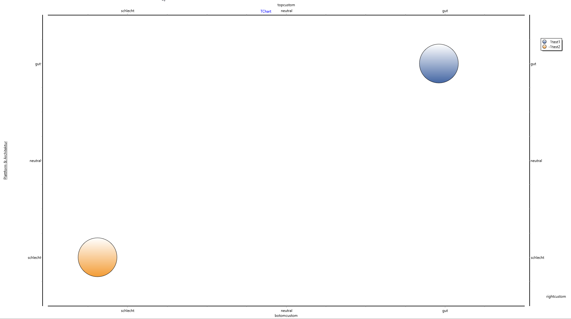

That works in the same way for me, but the problem is that I do not want digit values but simply good, neutral, bad labels on the axis and that on all sides of the chart ... (see attachment)
I had problems to get that.
Ok - I achieved what I wanted now, but I do not understand why I need to do it like that - imo it should be easier - perhabs it is and I simply use TChart not in a good way. But I guess a certain complexity cannot be prevented when a component is such mighty as TChart ...

Chart I want to achieve as easy as possible

You should be able to do the same using the default Left/Right/Top/Bottom axes instead of using Custom Axes:
var Series1: TBubbleSeries;
  Chart.View3D:=false;
  Series1:=Chart.AddSeries(TBubbleSeries) as TBubbleSeries;
  Series1.VertAxis:=aBothVertAxis;
  Series1.HorizAxis:=aBothHorizAxis;
  Series1.AddBubble(1,1,0.2,'test1');
  Series1.AddBubble(-1,-1,0.2,'test2');
  SetAxisLabelsGoodNeutralBad(Chart.Axes.Left);
  SetAxisLabelsGoodNeutralBad(Chart.Axes.Right);
  SetAxisLabelsGoodNeutralBad(Chart.Axes.Top);
  SetAxisLabelsGoodNeutralBad(Chart.Axes.Bottom);
procedure TForm1.SetAxisLabelsGoodNeutralBad(AAxis: TChartAxis);
  AAxis.Grid.Visible:=false;
  AAxis.Items.Clear;
  AAxis.Items.Add(1,'gut');
  AAxis.Items.Add(0,'neutral');
  AAxis.Items.Add(-1,'schlecht');
I've seen InflateMargins doesn't work fine for the Top axis in the TBubbleSeries when HorizAxis=aBothHorizAxis, so I've added it to the public tracker (B1197), and I already fixed it for the next maintenance release.
