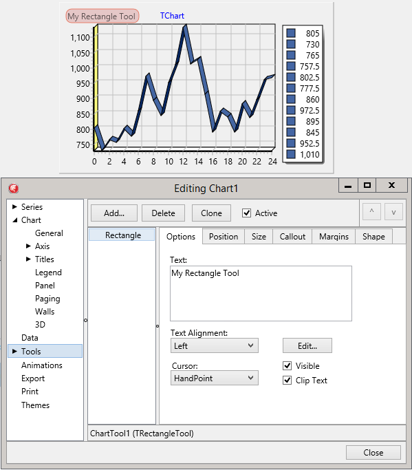

I've created a new FMX project in RAD XE8, I've dropped a TChart and a TTeeCommander on the form.
I've added a TLineSeries (with some sample values) and a TRectangleTool to the TChart at designtime.
Then I've ran the application, opened the editor through the Commander and I could modify the rectangle tool:
Do you see anything I may be missing to reproduce the problem?

I see. Using the TChartEditorPanel you need to add a unit to the uses clause in order to access the RectangleTool editor:
uses FMXTee.Editor.Tools.Annotation;
