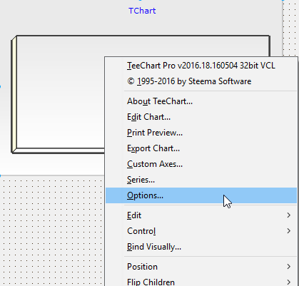

That could be the clue to follow. Maybe for some reason the language for your editor is set to Arabic (?) language.
Try changing it through the "Options" dialog:
I've changed mine to Arabic and I still can't see any error when opening "Tools\Options..." through. But worth giving it a try.

Your suggestion worked!
I had a slight problem at first because Options does not exist on the right-click menu in a Multi-Device (FMX) app. However, after creating a VCL application and following your suggestion, the problem was resolved for both VCL and FMX.
