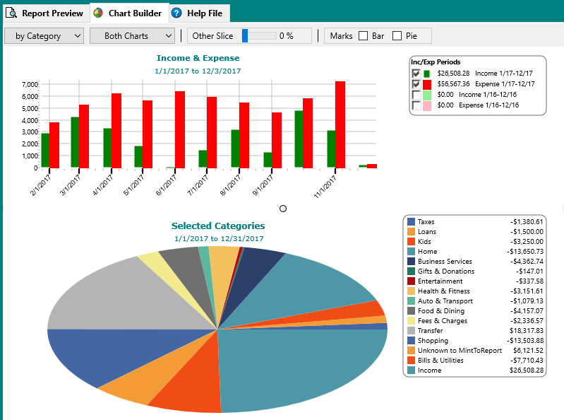

I have 2 charts separated by a splitter. The bar chart lets users select months, and that months categories are displayed in the bottom pie chart.
I want to make sure the user sees that clicking on the bar does indeed change the pie. I am new to Delphi Berlin (from Delphi 5) and am new to animations. I would like to create some sort of animation that will look like the pie chart is comming from the bar chart.
Any ideas how to accomplish this or any examples I could look at.
Attached is a screenshot of the charts.

Also, is there a way to make the legend multiline. I would like the dates displayed in the legend on the second line of the legend item.

realsol wrote:Any ideas how to accomplish this or any examples I could look at.
There are some animations shipped with TeeChart. You can see a couple of examples under "All features\Welcome !\Tools\Series Animation" in the Features Demo program shipped with the binary installation of TeeChart Pro.

You have seen my charts. My customers thought my 3D charts were dated. I tried my best to make them look more modern.
If I upgraded to the Pro version, could I take my charts (above) and make them look like this? https://vimeo.com/246186475
