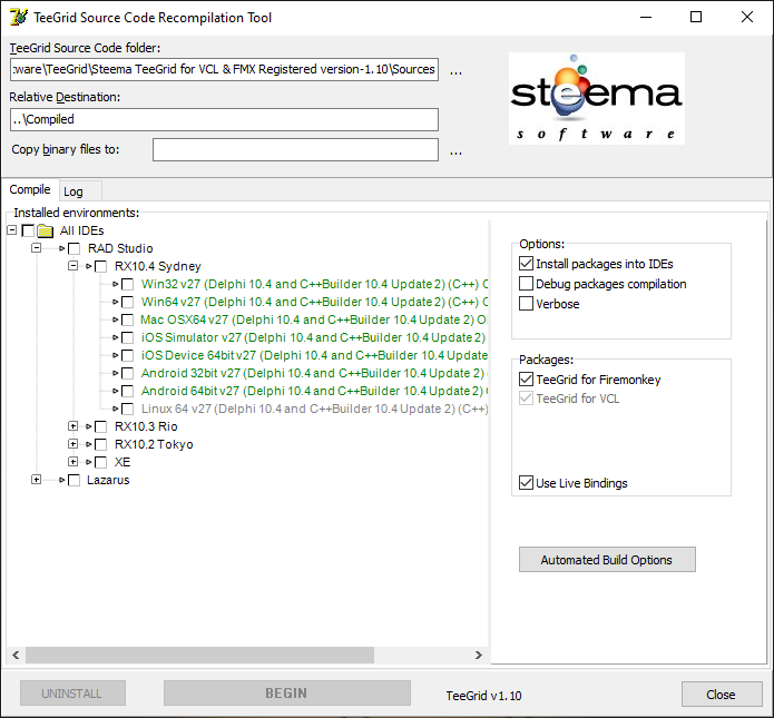

I am new user of the latest version Teegrid with source code using Delphi 10.4 Enterprise and FMXLinux but Teerecompile cannot build for Linux due to the option of linux being greyed out.

To use TeeGrid with FMXLinux on RAD 10.4 Sydney, you'd need to:
- Setup the linux machine with PAServer following the instructions here.
- Install TeeGrid with sources and run TeeRecompile:
* Note in the image above I compiled TeeGrid for MacOS64. You'd need to do setup a MacOS.

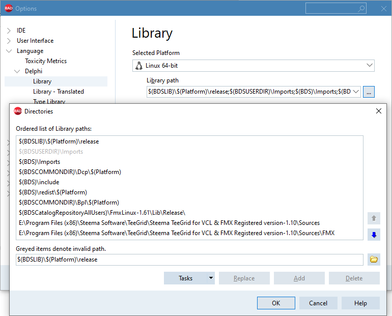

- Add the "Sources" and "Sources\FMX" folders to the "Library path" for "Linux 64-bit" platform:

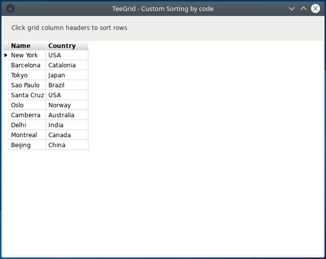

You should now be able to build and run applications in Linux using TeeGrid:
