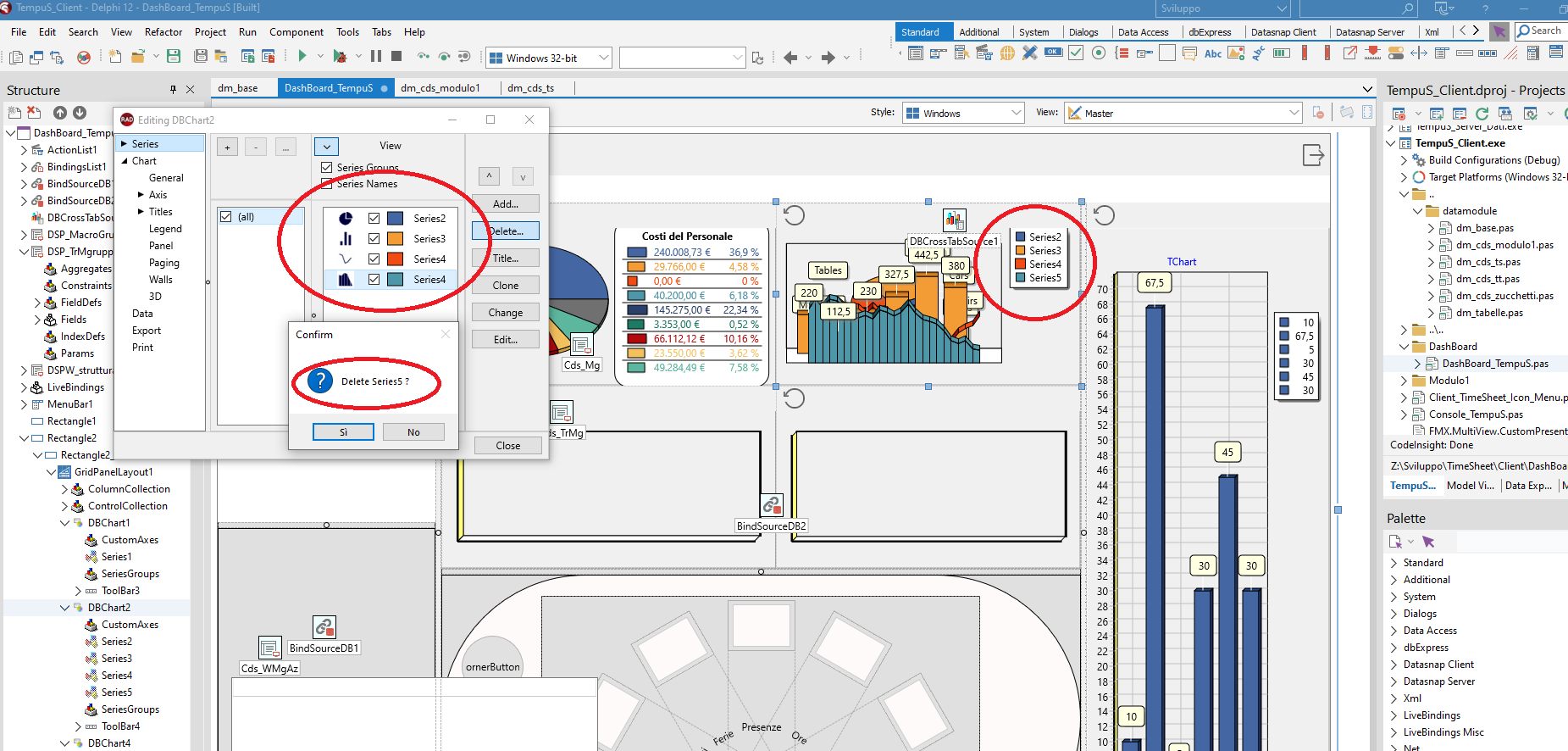

1) If I create multiple series in the groups and delete one from that moment the series counter displays the references incorrectly
(serial number error.png)

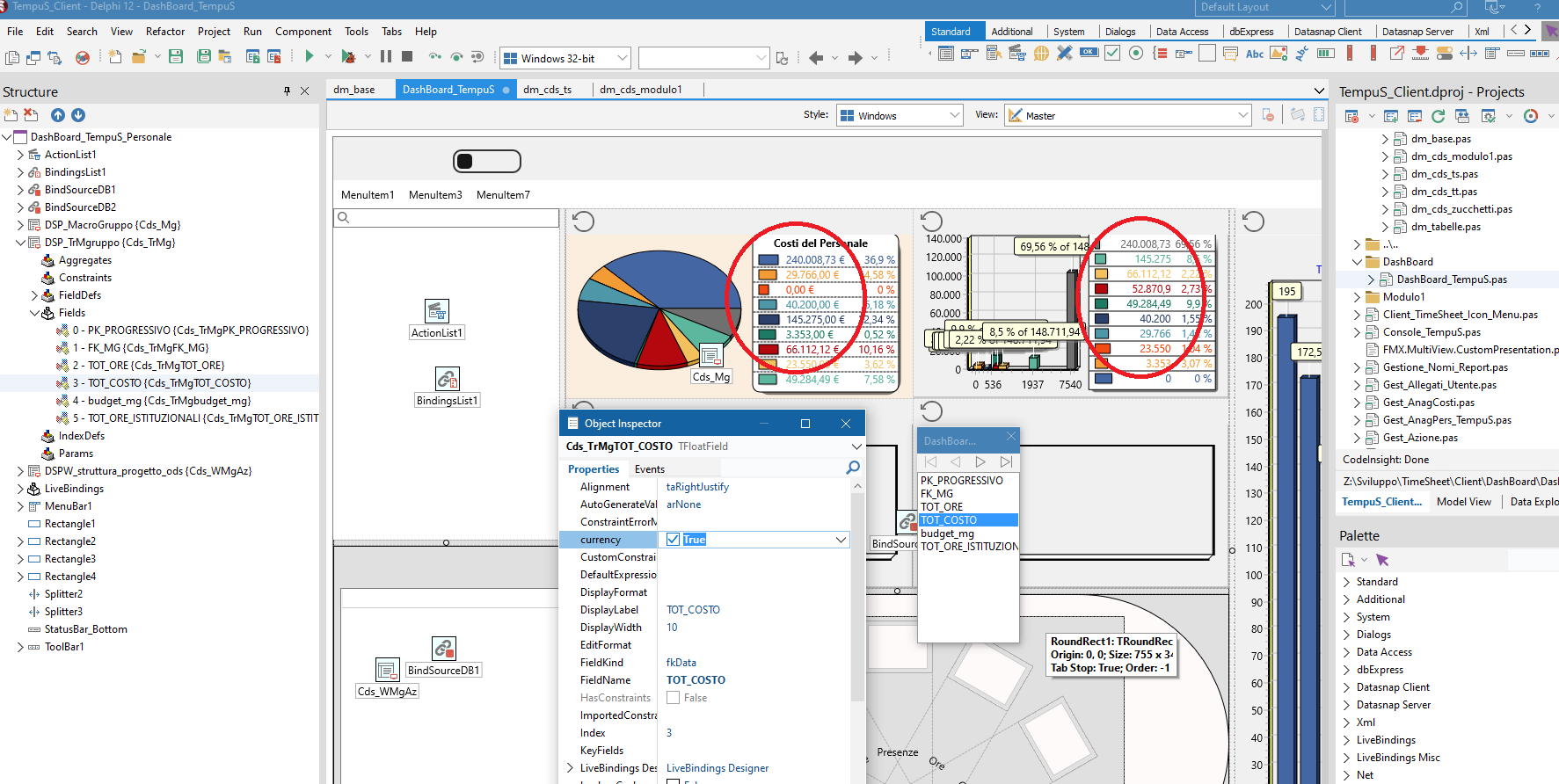

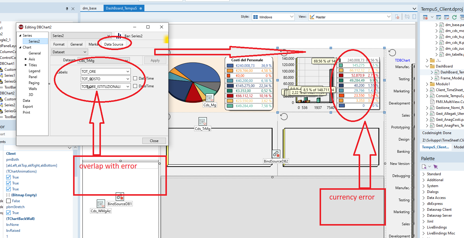

2) A persistent field of a tclientdataset set to currency is reported correctly if used in the label if used as the value of X the format is lost
(currency error.png)

- problem 2
- currency error.png (216.27 KiB) Viewed 114494 times
- problem 1
- series number error.png (244.82 KiB) Viewed 114494 times

- The
- The
Maybe we should save an internal
In the meanwhile, you could make sure you set a
When you create a series, no
Name
is set to it by default. And when a series doesn't have a Name
set, both the legend and the TChartListBox
(used to draw the series list in the Editor) use the SeriesNameOrIndex
function to calculate a string to draw each item. Then, the issues here are:- The
SeriesNameOrIndex
method gives Series1
always for the first series. If you remove the first series, then the next series will be Series1
.- The
TChartListBox
doesn't refresh when you remove a series. That's why the Editor and the Legend look out of sync. If you close the Editor and reopen it, they should be in sync again.Maybe we should save an internal
Name
when a Series is created, in a similar way as we do with the Series Color
, where we use a internal ISeriesColor
property. I've added it to the public tracker (#2694).In the meanwhile, you could make sure you set a
Name
property in your series. Ie using the GetNewSeriesName
function:
for i:=0 to nSeries-1 do
with AddSeries(TBarSeries) do
Marks.Hide;
FillSampleValues;
I'll take a look at this asap.

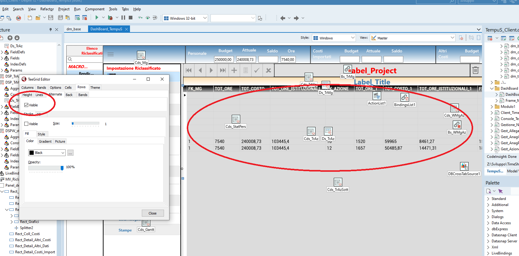

- DELPHI 12.1 form FMX
- currency error.png (133.77 KiB) Viewed 114322 times
- currency work fine.png (125.17 KiB) Viewed 114322 times

to supplement my report ": reporting two tdbchart bugs" (no response from you about this)

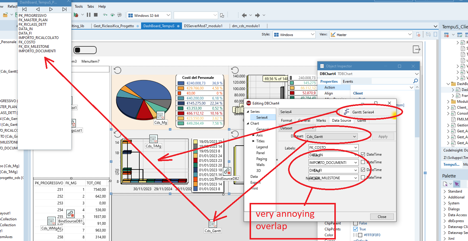

I attach a screenshot of a persistent and annoying label overlap when using the comboboxes for setting a dataset
Ciao
Raffaele Barone
Ciao
Raffaele Barone
- overlap label
- overlap.png (153.65 KiB) Viewed 114238 times

Re: reporting two tdbchart bugs
Regarding the problem in the Dataset Editor, where some
TLabel
s overlap some TComboEdit
s, I've added it to the public tracker: #2700 and I've already fixed it for the next maintenance release.Best Regards,

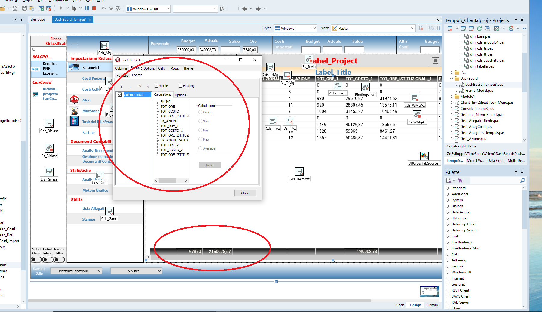

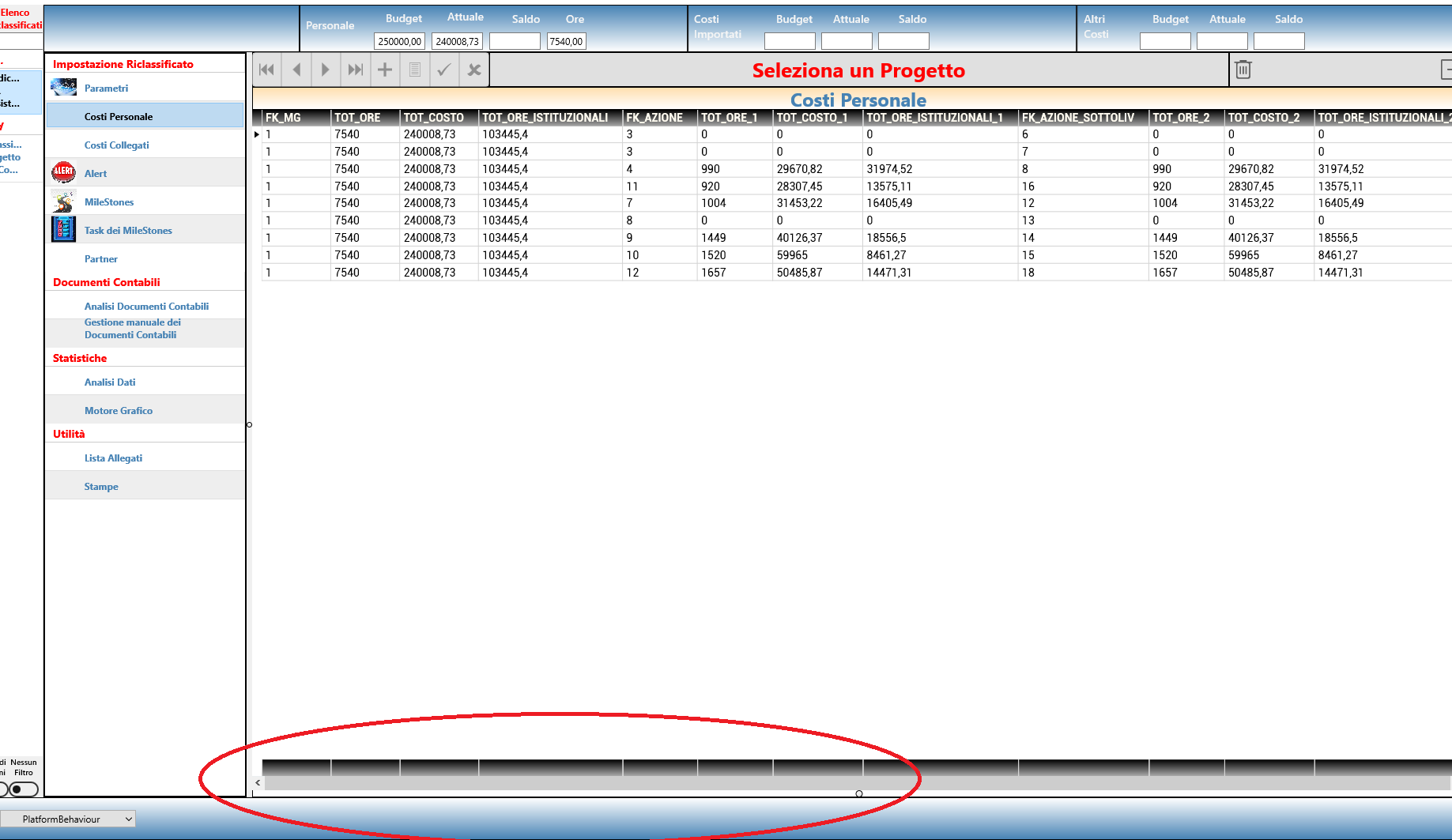

4) I would like to point out that I found another bug on the apply button of a Datasource/Summary, after having set the field and clicked on apply, if I change the field the apply remains disabled, to resolve it you need to change the Calculate (The apply button instead works correctly in the case of DataSource/Dataset) I attach a screenshot
Yesterday I renewed my TeeChart license and purchased the TeeGrid
The TeeGrid product itself is wonderful but yesterday alone I encountered numerous bugs with a TeeGrid/Dataset applied on an FMX/Rectangle or Panel.
All related to runtime visualization because at design time it seems to work.
I believe that many of the background/color properties have serious problems (probably in inheritance?).
Unfortunately more than 3 screenshots are not allowed to attach
I would like to know whether to communicate the other bugs to you or not, because in this way the TeeGrid product is truly UNUSABLE. (I attach some screen shots)
Hello Raffaele,
I used an FDMemTable just to give a simple test code we can run as-is at both sides. We can use as a starting point to try to reproduce the problems you are reporting.
I know this is a pain in the ***, but splitting each small bug in a separate thread, preparing a simple example for each one and posting it at the appropriate forum section (or directly at bugzilla) helps enormously to find the solution for each issue.
Sending databases back and forth adds extra complication. But some bugs, like some of the ones you report are quite attached to linking our components to some kind of dataset.
Sure. There may be some bug here we need to analyse.
I've been able to reproduce the problem so I've added it to the public tracker #2702 and I've just fixed it for the next maintenance release.rbarone wrote: ↑Fri May 03, 2024 10:32 am4) I would like to point out that I found another bug on the apply button of a Datasource/Summary, after having set the field and clicked on apply, if I change the field the apply remains disabled, to resolve it you need to change the Calculate (The apply button instead works correctly in the case of DataSource/Dataset) I attach a screenshot
I'm sorry to hear you are disappointed with some of the products. Please keep posting the bug reports as you are already doing. This helps us to improve the components.rbarone wrote: ↑Fri May 03, 2024 10:32 amYesterday I renewed my TeeChart license and purchased the TeeGrid
