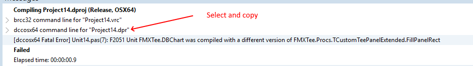

I was running RAD Studio 10.3.2.
The full command can be extracted from the "Messages/Build" panel:

[b][dccosx64 Error] Main.pas(10230): E2606 Duplicate resource: type RCDATA ID tmainform[/b]
[dccosx64 Fatal Error] test.pas(74): F2063 Could not compile used unit 'Main.pas'
Failed
Elapsed time: 00:00:07.3
Re: OSX64
Post by Yeray » Fri Oct 11, 2019 10:33 am
Check the .res files you are registering and make sure you aren't referencing anyone in two different but related units.
Posts: 19
Joined: Thu Aug 29, 2019 12:00 am
Re: OSX64
Post by » Sat Oct 12, 2019 12:32 am
I got the duplicate resource fixed, and everything is working. I have it out in beta right now. Perfect timing.
Thank you for both your patience and help.
