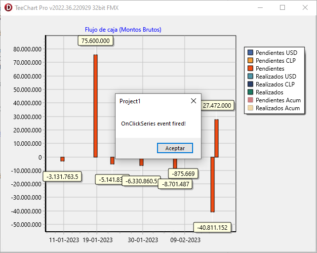

With following delphi code, I'm importing your tee file and adding an OnClickSeries event to the created TDBChart.
var DBChart1: TDBChart;
  Caption:=TeeMsg_Version;
  DBChart1:=TDBChart.Create(Self);
  LoadChartFromFile(DBChart1, 'F:\Downloads\teeFile.tee');
  DBChart1.Parent:=Self;
  DBChart1.OnClickSeries:=ChartOnClickSeries;
procedure TForm1.ChartOnClickSeries(Sender:TCustomChart; Series:TChartSeries; ValueIndex:Integer;
                                    Button:TMouseButton; Shift: TShiftState; X, Y: Integer);
  ShowMessage('OnClickSeries event fired!')
initialization
RegisterTeeStandardSeries;
And it seems to work fine for me here:
I'll give a try at the same in C++Builder.
