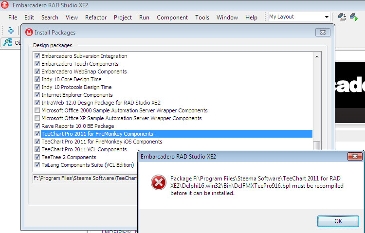

After the installation of TeeChart Pro 2011 in the RAD XE2 environment, the "TeeChart Pro 2011 for FireMonkey Components" checkbox on the "Install Packages" page is not available. An attempt to select the checkbox results in a message about the necessity to recompile DclFMXTeePro916.bpl (see the attachment). Since I have only binary files, I cannot recompile it. What should I do?

Please, make sure you have the Update 3 installed in the IDE.

I have the Update 3 installed in the IDE.

Could you please check if you have any 3rd party tool using TeeChart installed in the IDE?
If a tool is using another TeeChart version (ie the standard version bundled with the IDE) it may cause problems like this. Unselect any tool suspicious to be using TeeChart to see if then you can select TeeChart Pro for FMX.
It's strange because this kind of problems usually happen with VCL.

I don't have any third-party components using TeeChart Pro. I can imagine only one reason - that during installation of XE2 only the part related to win32 was installed (by selecting corresponding checkboxes in the installation menu). May be this is the case, what do you think?

This would be simple to check. Can you create&run a new&empty Firemonkey application?

Yes, I can create&run a new&empty Firemonkey application (see attachment).

I could run your project. Then I've added a chart to it and it still works fine for me here.

I still think it has to be something related to the paths or a 3rd party tool.
