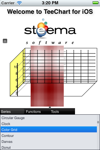

I tried that example but there are obviously major drawing problems on iOS, especially
with the text on the axes. Just have a look at the attached screen shot from the simulator.

I am using Xcode 4.2 on Lion, together with the FPC(2.6.0)/Firemonkey install from XE2 update 4.
There are lots of similar problems in all charts.
Is there any fix for that?
Otherwise this version is pretty useless.

Hi X-Ray,
This is probably related to a Delphi bug: http://qc.embarcadero.com/wc/qcmain.aspx?d=103976. The workaround is modifying "/Developer/Embarcadero/fmi/FMX_Types_FPC_Impl.inc" as described in the Quality Central description. Due to 103976 many TRectF methods are failing.

Hi Narcis,
Thank You!
That fixed all the problems, TeeChart is now working nicely on iOS!
