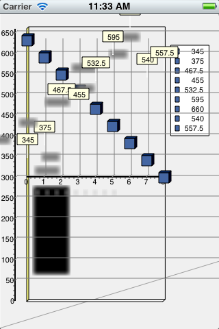

Re: Apply the fix to FMX_Types_FPC_Impl.inc
Still doesn't work
I have tried tried this
1 added a copy of FMX_Types_FPC_Impl.inc with er errror in the project folder
2 removed all FMX_Types_FPC_Impl.inc files on my Mac
Nothing changes, the project still compiles as before without error (only the chart error)
Jørgen
Jørgen
