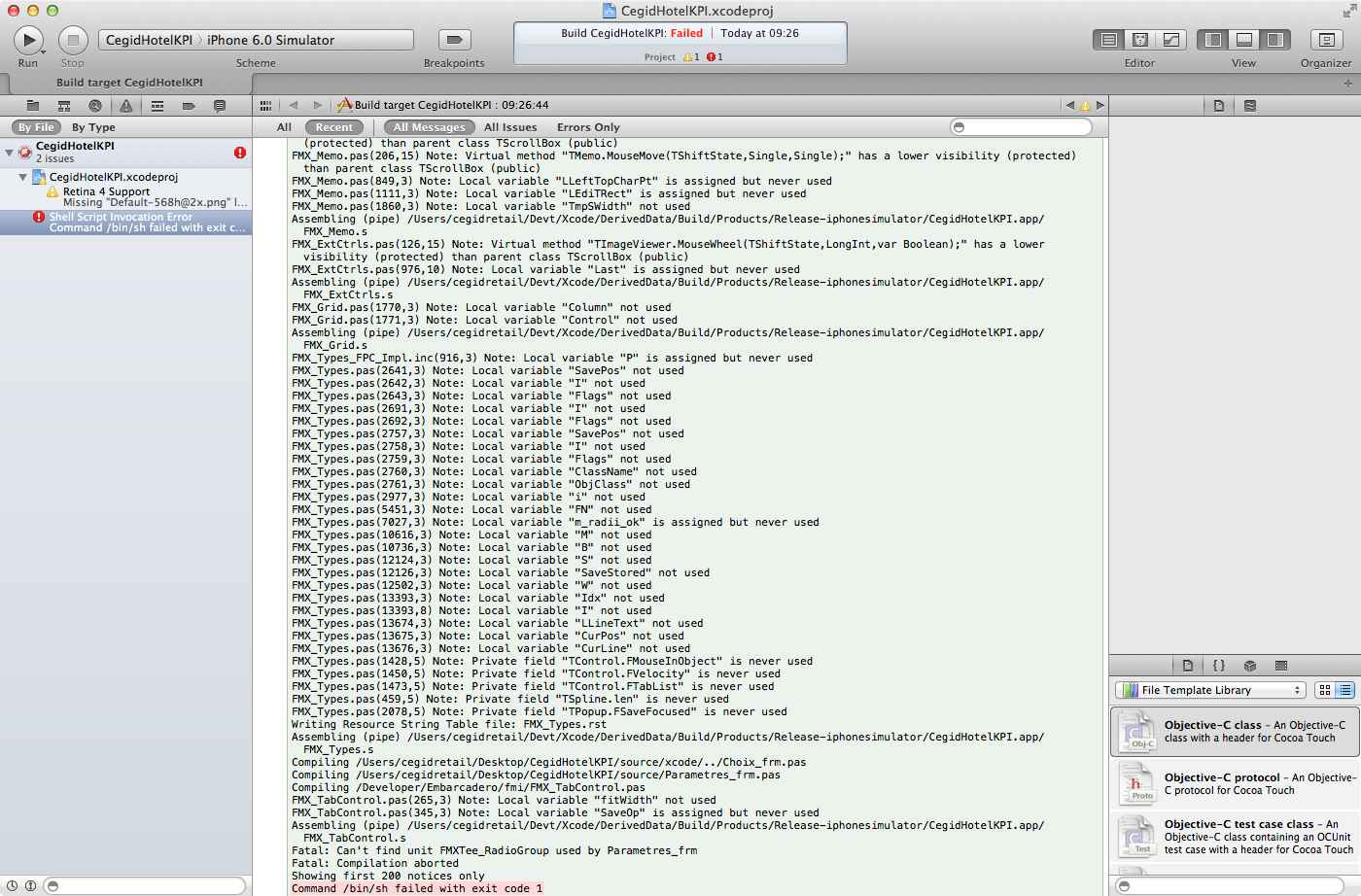

I'm a new comer in the FireMonkey/Xcode world and I've a problem to build my Delphi XE2 project into Xcode.
PC side, in Delphi XE2 Update 4 HotFix 1, I use many TeeChart units and my application works fine. All the graphics (TChart component) displays well. I installed "TeeChart2012StandardSourceCode.exe", I recompiled it and installed it. All the packages are fine installed into Delphi XE2. I've exported the project to Xcode.
Mac OS X side, I have Xcode 4.5 with Free Pascal Compiler 2.6.0 and FireMonkey-iOS.dmg (from the XE2 Update 4 HF1 installer). The installation seems OK. But when I build my XE2 project on Xcode, I obtain this error :
"Fatal: Can't find unit FMXTee_RadioGroup used by Parametres_frm".
All the "FMXTee_*.pas" are missing. I think I've missed something to do... but what ?
I was thinking that the TeeChart units exports by itself within the Xcode project. How can I specify to Xcode where are the FMXTee units ?
Here is the error details :
Compiling /Users/cegidretail/Desktop/CegidHotelKPI/source/Parametres_frm.pas
Compiling /Developer/Embarcadero/fmi/FMX_TabControl.pas
FMX_TabControl.pas(265,3) Note: Local variable "fitWidth" not used
FMX_TabControl.pas(345,3) Note: Local variable "SaveOp" is assigned but never used
Assembling (pipe) /Users/cegidretail/Devt/Xcode/DerivedData/Build/Products/Release-iphonesimulator/CegidHotelKPI.app/FMX_TabControl.s
Fatal: Compilation aborted
Showing first 200 notices only
Command /bin/sh failed with exit code 1
Does someone may help me please ?
I can upload the Xcode project if you want.

- Screenshot.Build.Error.TeeChart.jpg (163.94 KiB) Viewed 28562 times

These files are included with the Source Code installation. Have you tried copying them to the Mac OS side?

Yes, I found these files in the Source Code installation, and I tried to copy them to the Mac OS Side, but I don't know where I need to copy them...
Many developer should have the same problem, I think. Because, it is pretty commun to Export to Xcode from Delphi by using your TeeChart components.
Someone can help me, maybe ?
I gonna try to copy the missing TeeChart files to Mac OS X side
I hope I'll find the location where Xcode try to load these files!

OK, I copied the content of the FMI folder to the FMI folder on the MAC, overwritting the previous TChart sources (which were working).
After that I tried to compile my project again and I get the following compilation errors (starting just before the first error):

I found a previous post on the forum where the customer had the same error.
You had sent to him an email with a bug fix. May I have this version please ?
Thank you in advance,
Arnaud

Hi Arnaud,
You should have the TeeChart sources (FMI folder) at "/Developer/Steema/fmi" in the Mac side. And you should add the following in your xcode project, with the line where the other "-Fu" are:
As you will see it already is in the iOS demo here.
I'm not sure to understand the above. What TeeChart sources were already in the Mac?djoulaie wrote:OK, I copied the content of the FMI folder to the FMI folder on the MAC, overwritting the previous TChart sources (which were working).
-Fu/Developer/Steema/fmi

So, I created the TeeChart sources FMI folder at "/Developer/Steema/fmi" in the Mac side.
In the PC side, I took the files included in the folder "C:\Program Files\Steema Software\TeeChart Standard 2012 Source Code\Sources\FMI", and I transfered them to the Mac side in the folder just created, "/Developer/Steema/fmi".
Tell me if I did something wrong...
And the last thing to do : Add in my Xcode project the line : "-Fu/Developer/Steema/fmi".
But I don't find where to do that... ? I have to learn about Xcode.
Do you have a "technical note" (or something like that) who explains each step from the Delphi XE2 compilation to the Xcode compilation (with TeeChart components in the source code) ?
