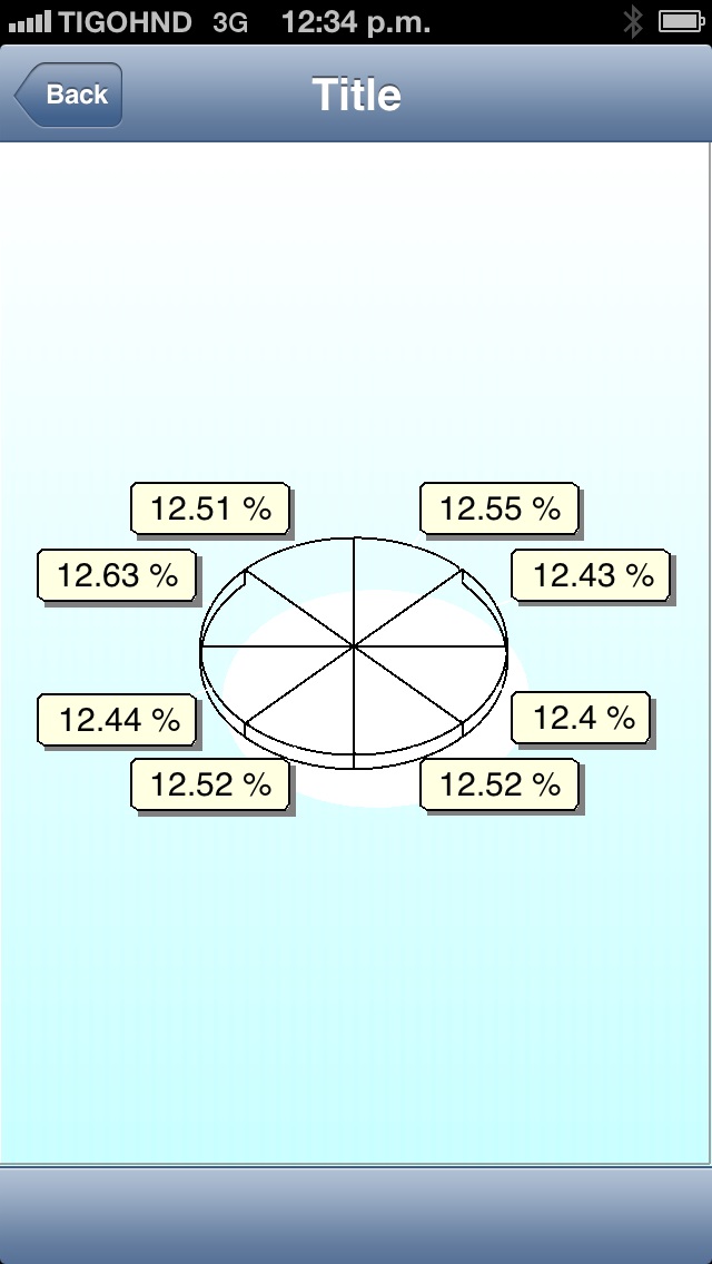

I'm developing an App using TChart for iOS, when I use the component on a Blank Application template the chart is displayed with no problems, but when I use a Header/Footer with Navigation template, and place the TChart component on the second tab of the TabControl, the chart is not drawn Ok.
I have attached an Image.

- IMG_1047.jpg (97.19 KiB) Viewed 11766 times

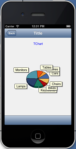

I have tested this in an iOS Simulator and worked fine as well:
Does this work fine at your end? I'm using RAD Studio XE4 with Update 1. If the problem persists please attach a simple example project we can run "as-is" to reproduce the problem here.
