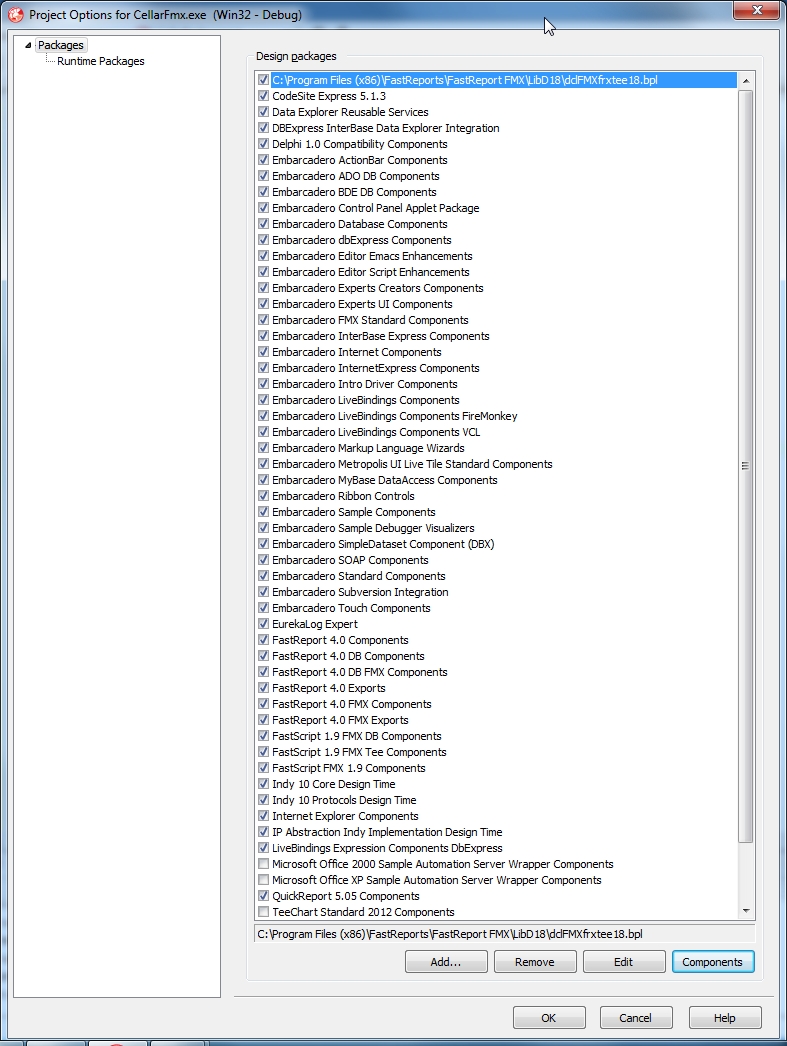

None of the files you named are in the packages list
The only possible candidates I can see (both from FastReports) are shown highlit in the two screendumps attached (combined these screendumps show the full list of installed packages I have)

Hi Uncork,
Yes, that must be the problem then, FastReports packages that are still using the old TeeChart versions. You could try disabling them and enabling new TeeChart packages. If that works then you should consider updating your FastReports for TeeChart components to your current TeeChart version. You could ask FastReports for packages compatible with your TeeChart version or, if you have FastReports sources, do something similar to what's explained in the QuickReport article.
Re: XE4 Fmx Teechart Standard installion problems
I already had the most recent FastReports FMX installed - but I do not use tCharts in it, so I ....
1. uninstalled FastReports FMX
2. Removed the remaining (presumably Embarcadero standard VCL) FastReports
3. Re-installed FastReports FMX - but EXCLUDED the Tee components
... and everything seems to be OK - or at least loads and I can enable the TChart components (labelled version 2012 but the description says 2013) then view my chart form again
Thanks for your help - you can close the ticket
Brian
