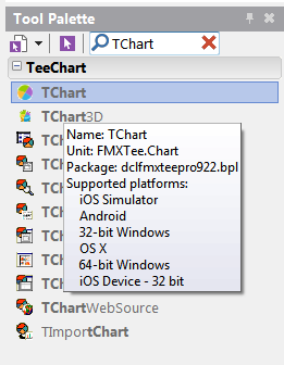

after installation of the latest TeeChart FMX from souces, via the TeeRecompile.exe TChart is diabled for the 64Bit iOS platform.
Is that done on purpose, because there are problems ?

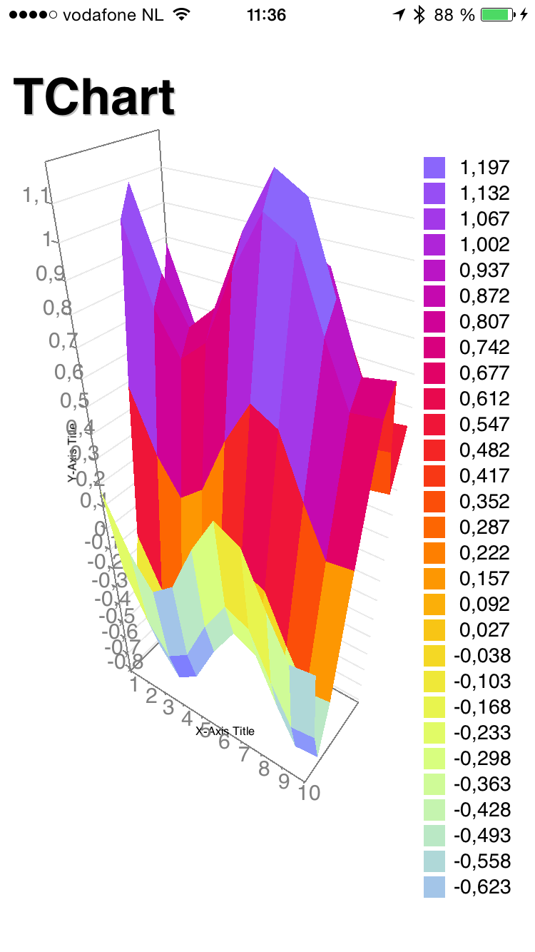

there are problems with axes titles in 3D that got worse with the latest release 2015.16:
I used the gesture example and added titles for the X-Axis (Bottom Axis), Y-Axis (Left Axis) and the Z-Axis (Depth Axis). What you see is (on a iPhone 6):
1) The titles are not aligned with the axis labels (This works well in the VCL version)
2) The distance between the axis labels and the axis title is too short (how can I change this ?)
3) The Z-Axis title has disappeared or is somewhere far away
Are there any fixes for this ?

Instead, you could draw your title or text manually. Ie:
I've tried it with v2015.15 and v2015.16 in Android and it seems to give the same result. Could you please specify what two versions to compare?X-Ray wrote:there are problems with axes titles in 3D that got worse with the latest release 2015.16:

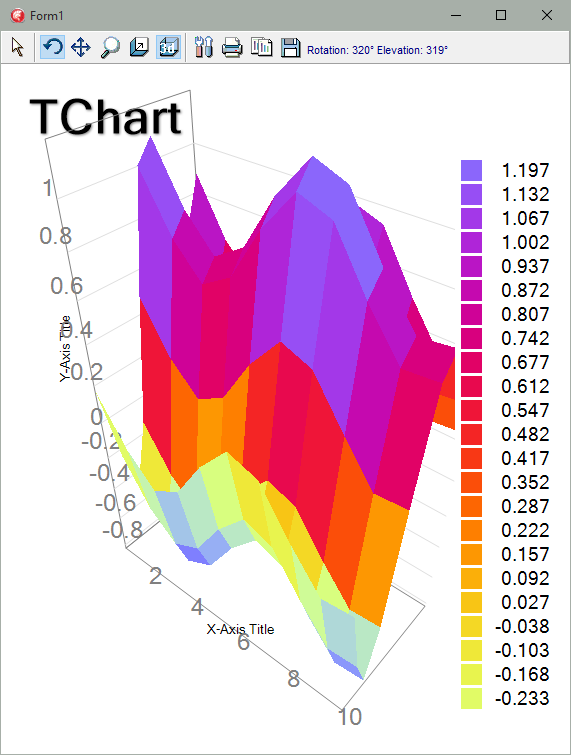

I get the same result with VCL:X-Ray wrote:1) The titles are not aligned with the axis labels (This works well in the VCL version)
I'm afraid this is not possible.X-Ray wrote:2) The distance between the axis labels and the axis title is too short (how can I change this ?)
procedure TForm1.Chart1BeforeDrawSeries(Sender: TObject);
var yOffset, tmpZ, tmpW: Integer;
pos: TPointF;
st: string;
yOffset:=10;
with Chart1.Axes.Bottom do
st:=Title.Caption;
Chart1.Canvas.AssignFont(Title.Font);
tmpW:=Chart1.Canvas.TextWidth(st);
pos.X:=IStartPos + ((IEndPos-IStartPos) div 2);// - (tmpW div 2);
pos.Y:=Round(Chart1.Axes.Left.IEndPos + Abs(LabelsFont.Size) + TickLength + 7);
tmpZ:=Round(Chart1.Width3D * ZPosition * 0.01);
pos:=Chart1.Canvas.Calculate3DPosition(pos,tmpZ);
pos.Y:=pos.Y+yOffset;
Chart1.Canvas.TextOut(pos.X, pos.Y, st);
The depth axis is not visible. It will appear if you make it visible:X-Ray wrote:3) The Z-Axis title has disappeared or is somewhere far away
Chart1.Axes.Depth.Visible:=true;
