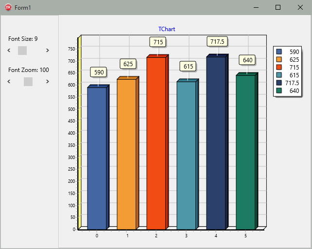

Have you tried the latest TeeChart version v2015.16 in RAD XE6 to check if the problem is in the IDE or in the component?
I've made a simple test and this is how it looks with RAD 10 and TeeChart v2015.16:
FMXFontTest.zip
(1.64 KiB) Downloaded 1091 times

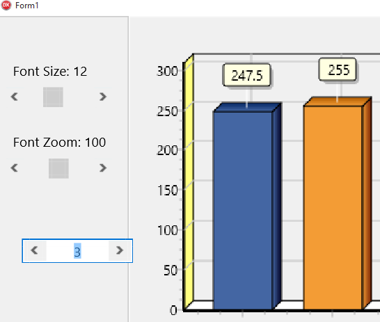

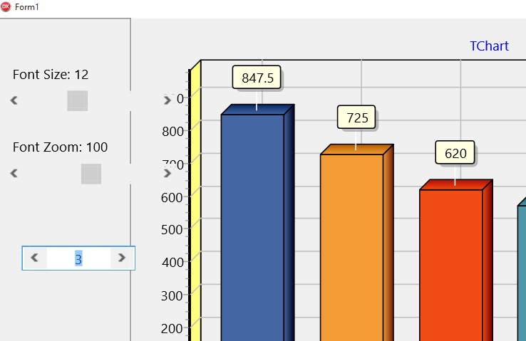

Hi
the issue is when its on a tlayout and that is then increased in scale
e.g via a spinbox
layout1.Scale.x:=layout1.Scale.x+spinbox1.Value/10;
layout1.Scale.y:=layout1.Scale.y+spinbox1.Value/10;
I could duplicate the problem with your test project

Hi
I have attached this test project to show the problem and pictures
tchartfonttest.zip
(57.47 KiB) Downloaded 1007 times
