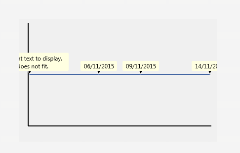

I have an issue with the marks not displaying text when they are on the edge of the chart. Please see the screenshot.
The text of marks does not fit

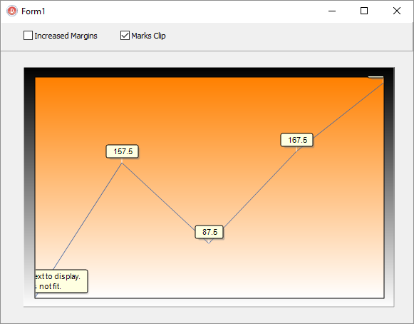

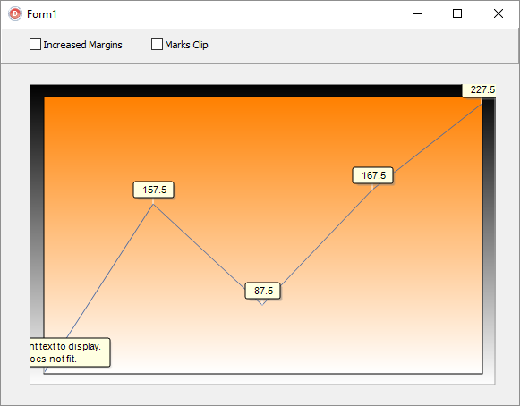

You get something like this when I run it:
Note the orange rect is the ChartRect; this is the area delimited by the axes, where the series are drawn.
And the black area behind is the whole TChart component. Note TChart can't draw anything out of this area.
If you set the series marks clipping, the marks will be clipped in the ChartRect area:

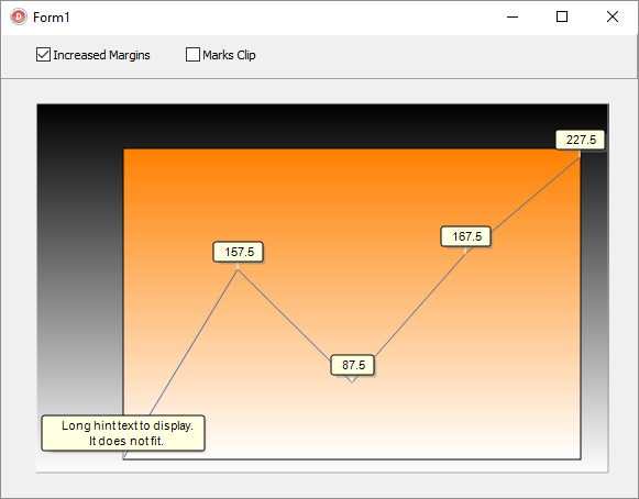

Instead, what you probably want is to increment the margins to fit the marks into the TChart component:
