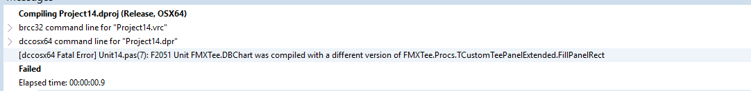

When I try to compile the program, I get this:
Compiling gives me this error: [dccosx64 Fatal Error] FMX.fs_isysrtti.pas(15): F2051 Unit FMX.fs_iinterpreter was compiled with a different version of FMX.fs_isysrtti.TfsSysFunctions
How do I fix this?

Paul from Fast Reports helped me get past the last error. But it looks this error is indeed a TeeChart error.
[dccosx64 Fatal Error] Main.pas(41): F2051 Unit FMXTee.DBChart was compiled with a different version of FMXTee.Procs.TCustomTeePanelExtended.FillPanelRect
How do I fix this?
You can read the error description at Embarcadero's documentation (here).
This makes me think there may be a confusion in the TeeChart version(s) being used.
Can you reproduce the error without FastReports, just with a Chart in a Form?
As mentioned before, it would be helpful if you could arrange a simple example project we can run as-is to reproduce the problem here.

Your right. Compiling a new project with OSX64 and TeeChart only compiles just fine. Then I went to drop a FastReport component, but all the Fast Report components were grayed out on OSX64. Fast Reports doesn't offer a recompile.exe that includes OSX64. Maybe by not recompiling would help, but I think it there is a problem with Fast Reports OSX64, even though all the paths are correct. I will send this off to Fast Reports and let you know what happens.

I worked with Fast Reports and they had me remove all of the .pas files from the Fast Reports OSX64 folder and got past the Fast Report errors. They had me create a new project and add just the FMXTee.DBChart to the units of the project. Attached are the errors and a zip file containing the project. Notice that on the component pallet (toolbar), all of the TeeChart components are grayed out. Not sure how, or if, I compiled TeeCharts on a fresh project, but here are my results.

I could open, compile and run your project without errors here.
I also created a new FMX project, added FMXTee.DBChart unit and compiled for OSX64 without errors.
Could you please share the complete "dccosx64 command line..." the IDE is trying to execute?
