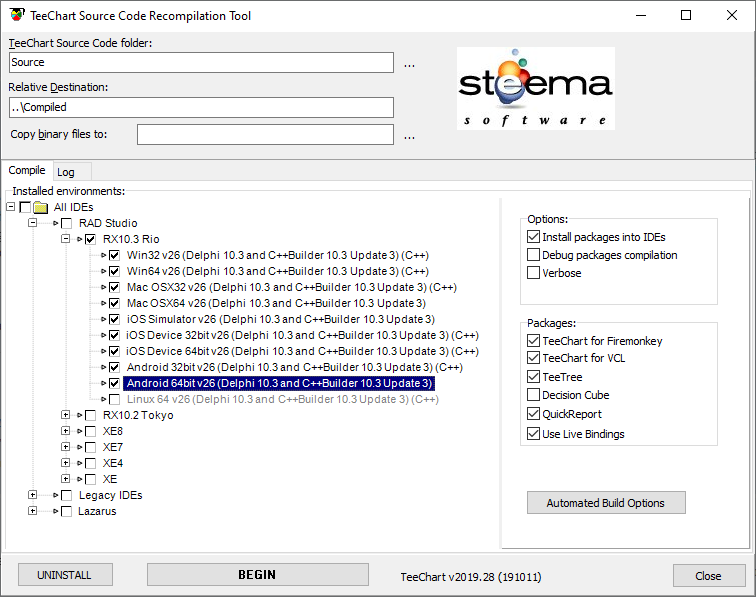

How can I manually recompile with TeeRecompile tool for Android64 ? I cannot find it.
Posts: 9476
Re: Rio 10.3.3
Post by Yeray » Wed Jan 08, 2020 12:37 pm

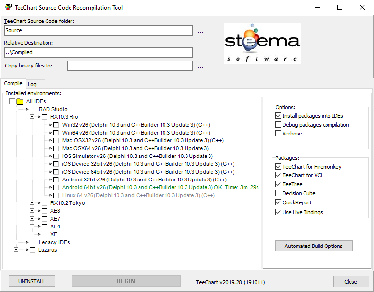

You can select it in TeeRecompile:
And it should be able to compile:
