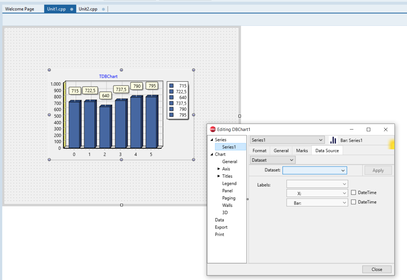

Hi, I need some help with a TDBChart.
I have a FMX application with a main form. Also I have a TDataModule where put a TFDConnection and a couple of TFDQuery.
The main form is including the TDataModule. Then I added a TDBChart on main form and a Series1.
When I edit the TDBChart to specify a Dataset for the Series1 it didn't show the query's that I have on the data module. I have selected Dataset option on the first combo box on the Data Source page, however the second Dataset combo box remains empty.
I'm working with C++Builder 10.4.2 recently launched and with 2020.31 version of TeeChartVCLFMXStandard.
What could be wrong?
Best regards,
Patricio Cerda
Can't access dataset's
- TDBChart screenshot.png (200.18 KiB) Viewed 85626 times

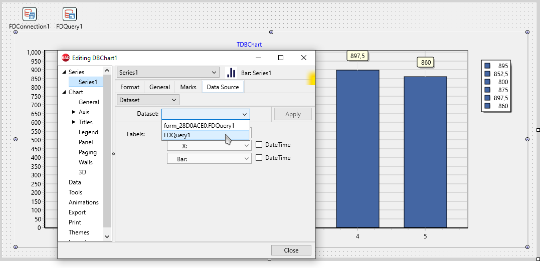

I've tried it in a new simple project and it seems to work without problems:
Have you tried it in a new simple project?
If you still find problems with it, please send us a simple example project we can run as-is to reproduce the problem here?

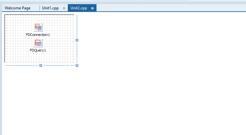

Thanks Yeray for your help.
I just tried with a new project replicating the same conditions of my project and the problem comes again.
The difference with your example is that you are putting the TFD components on the same main unit, instead of put them on a separate Data Module as on my case.
On my simple test project I added a unit2 (the datamodule with TFD components) and then I included it to the unit1 (main form) so now I have an #include "Unit2.h" sentence in the unit1, however I can't see the query component on the TDBChart.
I'm attaching my simple testing new project for your revision, and a couple of screenshots.
